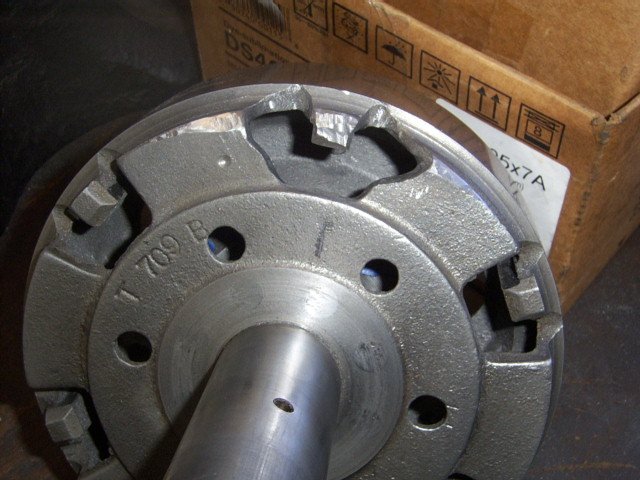

Removed 18 grams from the brake drum photos
Posted: Tue Apr 09, 2019 1:23 pm
by RGould1910
I was careful not to disturb stuff on the inside.
Re: Removed 18 grams from the brake drum photos
Posted: Tue Apr 09, 2019 1:27 pm
by ChrisB
Richard, was it balanced after that?
Posted: Tue Apr 09, 2019 1:33 pm
by RGould1910
Forgot to add the balancing was done with the driving plate attached and after other stuff was done. It balances very well on a static balancer.
Posted: Tue Apr 09, 2019 1:36 pm
by RGould1910
Yes Chris it was a back and forth job of removing stock and placing it on the balancer until there was no heavy side and the the brake drum/driving plate assembly came to rest without favoring a position.
Posted: Thu Apr 11, 2019 6:08 am
by Allan
Richard, did you take anything off the driving plate?
Posted: Sun Apr 14, 2019 4:15 pm
by RGould1910
No Allen I only took stock off the brake drum. I did have have the driving plate attached of course but there was no place I could take off any appreciable amount from it.
by RGould1910
Posted: Sun Apr 14, 2019 6:28 pm
by Allan
Richard, I asked because sometimes it means less of a hole has to be dug in the drum. If I find that much needs to be removed I juggle the driven plate around to a different position to see if that makes any difference to the out-of-balance before starting o the grinding.
Posted: Mon Apr 15, 2019 8:44 am
by RGould1910
I rotated the driving plate to where there was the least run out of the tailshaft before balancing.
