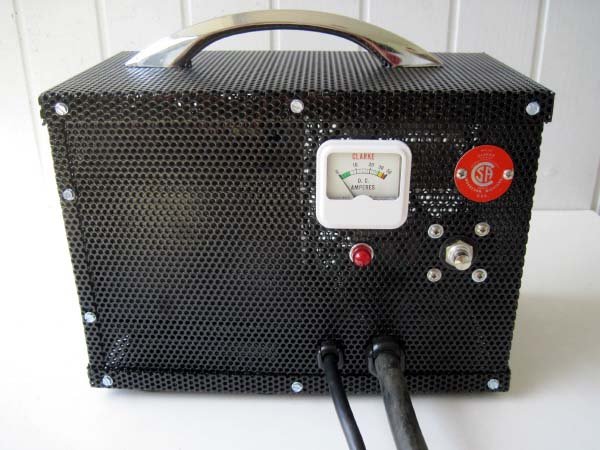

I have a 40 Volt/40 Amp Battery Charger that was originally used to charge six golf cart batteries and I restored.
Charger Front.JPG (72.65 KiB) Viewed 1681 times
I removed the switch that would turn it on for 8 hours and then turn it off and replaced it with a push button switch.
Holding the button in for 10 or 15 seconds gave a better charge that the 3 short push button zaps.
One time the connection fell off the terminal, drew a lot of sparks and popped a circuit breaker.
