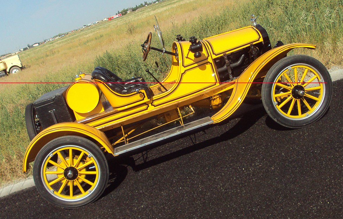

by Rich Eagle
This is too steep for our Speedster with a full tank.
We backed up the last 2 miles of the Jackson (WY) pass years ago. Had we filled the tank at the last stop it would have made it fine. A bus load of foreign tourists pulled out and watched the event. I believe this illustrates how different a full vs empty tank would be.

by MKossor
Clever and informative illustration Rich
The picture is worth 10,000 steps to the nearest gas station :-)
