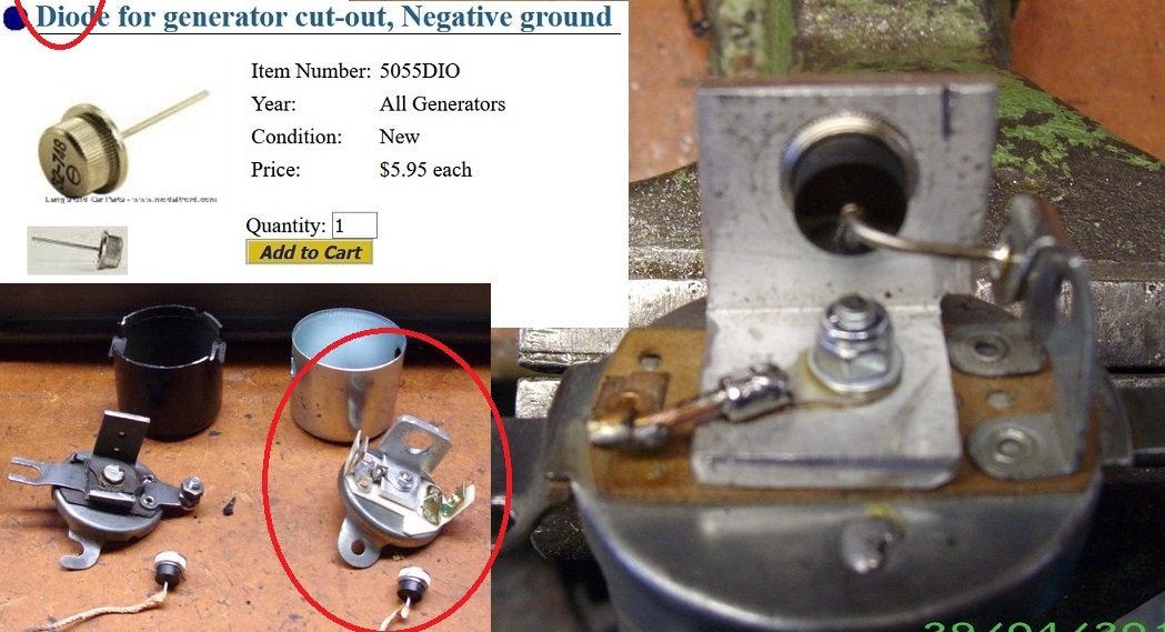

Good idea by speedytinc » Tue May 10, 2022 5:45 pm
you can buy a tractor type diode unit on fleabay for under $18 Or convert a stock cutout to a diode for around $4.
Conversion is easy and the ebay Cutout may even have a diode
This is all that needs to be done to diode a cut out passing voltage in the correct direction
