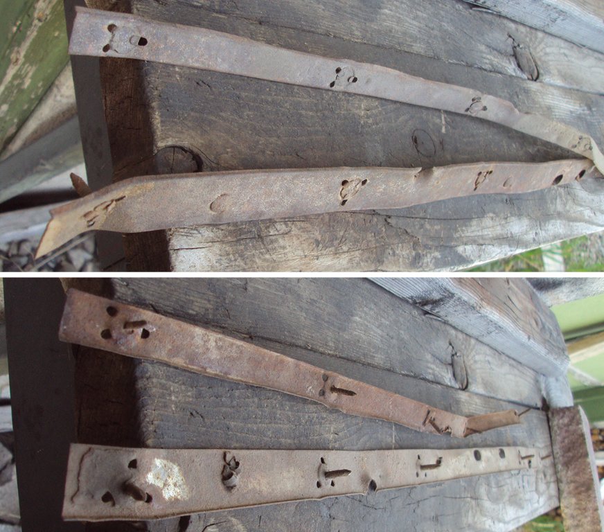

Do these look Model T? They were securing the older upper door window trim.

I think they may be what is shown here. Not sure and it's hard to see.

I completely replaced the interior in a friend's '25 Fordor sedan with a Cartouche upholstery kit about 20 years ago. The existing interior was completely original to the car.
The original door window surround pieces were stamped, tinned strips of sheet metal with ring shank nails attached to the metal strips, as shown above in the fotos posted. The strips of metal were padded with thin upholstery cotton and then covered with cloth material.
The replacement door surround strips were simply cardboard strips with the nails driven through the cardboard. There was no padding between the cardboard and the upholstery material. Very disappointing.
Since the nails were already in place, I had a devil of a time matching the nails with the holes in the doors.
Finding ring shank nails is not a problem. What seems to be the problem is finding the "Glove Fasteners" that the Service Bulletin speaks of.
There are modern replacements for the glove fasteners but, unfortunately, the modern replacements are made of plastic and do not sit as flush to the door as the original stamped metal ones leaving a gap between the surface of the door and the underside of the upholstery strips.
The usual way to fasten your hip pads is to use small brads, driven through the upholstery material, padding, and the panel board into the wood surround. They will not show once set. If the upholstery is sunken at the site of the brad, simply take a large upholstery needle and carefully insert it into the upholstery material near the dent and raise the needle and the material will pop up burying the brad.

Many thanks for the info, that definitely looks like what I have.
