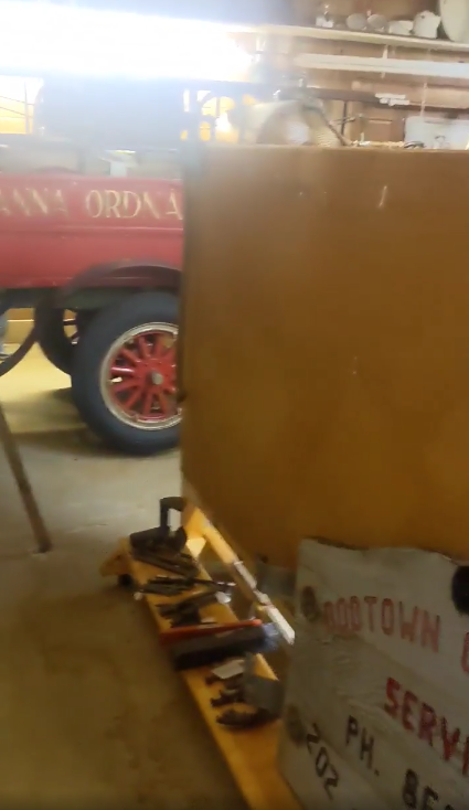

by 1925 Touring
Thank you all for the input! I will have to look at the car closely the next time I see it.
I am finding these photos in the above video, since I do not have access to a camera that I can upload pictures onto the forum. I will also be losing my computer on the 25th so I will not be able to post on the form for a while. I will have to look at the car, but I don't know if it has a wood firewall, and the coils are in the same spot on the dash. I do not know about the rest of the holes everyone has mentioned. I think that the car has a high radiator, but I will have to measure it.

There are a lot of Model T's with parts from different years. Some are such a scramble of parts that they're known as bitsas, Johnny Cash cars, or parts salads. It's possible that's what you have here.

Could the number on the hood be the number of the fire department, or did ordnance depots have that sort of thing? Maybe it is not the year? :?:

Posted: Wed May 18, 2022 11:13 am
by hull 433
The visual difference between low and high hoods can be tricky. I've found the best way is to look at the car from the side -- if the hood hinge is close to the top of the headlight, its a low hood. If there's a bit of space between the two, its a high hood.
Your truck looks like a high hood. That, plus the apron and fender style supports a March 1925 date as the engine number states.
The date "1923" painted on the hood looks like it was added over the past fifty years, probably by someone who sincerely thought that was the year of the truck.
