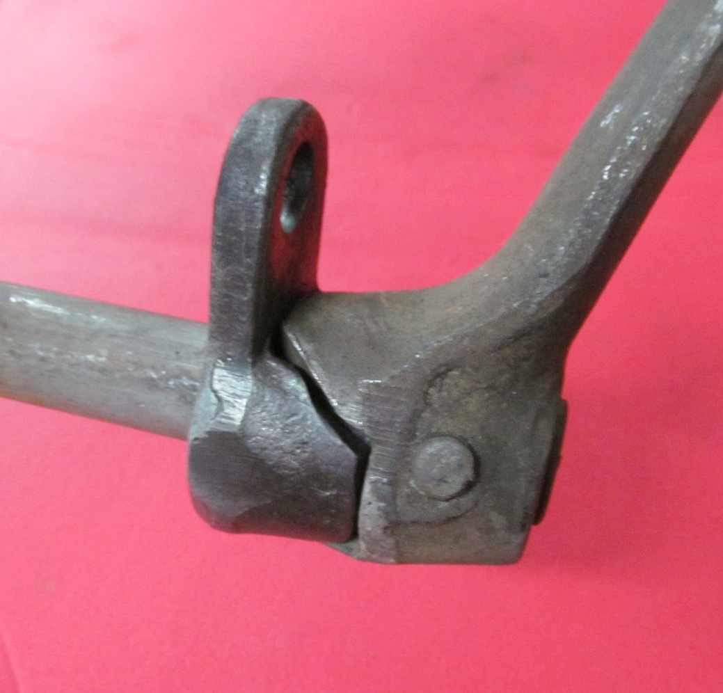

IMO the reproduction pedal cams are just fine, sure beat old used worn cams, now if you CAN find NOS pedal cams...great :P But don't hold your breath!
What works good is a pedal in good shape when coupled to a repro pedal cam, action is restored about the best you can do.
Worn cam compared to reproduction.
Worn cam on a original pedal as removed.
Reproduction cam on same pedal, good fit and function.
