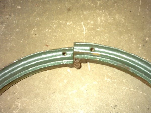

I can make the missing part but what does the pin look like that goes thru both parts of the latch?
Re: Split rim latch
Posted: Sun Jun 12, 2022 3:55 pm
by RajoRacer
That's a Canadian rim - I recall the pin looking like a door hinge pin with a head on one end.

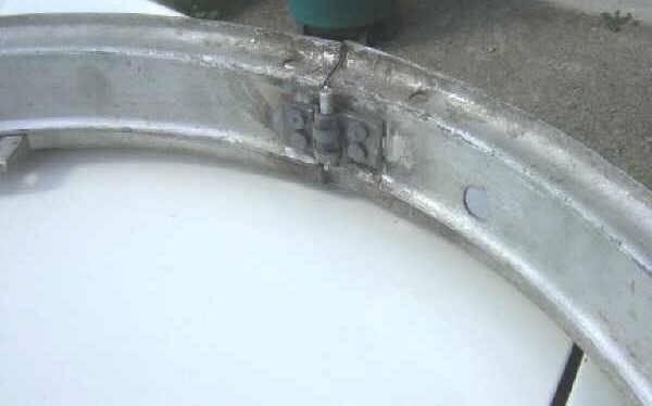

by J1MGOLDEN
The missing piece is identical to the piece showing.
Canadian Rim.jpg (51.52 KiB) Viewed 3140 times

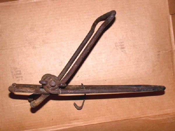

by J1MGOLDEN
There is a special tool to go in those holes to collapse or expand the rim when changing the tire.
Canadian Rim Tool Side.jpg (41.95 KiB) Viewed 3137 times
Re: Split rim latch
Posted: Mon Jun 13, 2022 9:14 pm
by J1MGOLDEN
This photo shows the whole latch assembly.
Kelsey Rim Lock 100.JPG (18.53 KiB) Viewed 3137 times

My rim does not have the two big holes on the side as shown in J1M Goldens picture
Re: Split rim latch
Posted: Tue Jun 14, 2022 8:47 pm
by Allan
Without the holes in the sides of the rim, you have something unusual. There were lots of rims without the holes, but I am unaware of any of these having that 'hinge type' joiner. Be aware that if you replace both sides of the 'hinge' joiner, the pin holding them together must be oriented so that it is entirely on one side of the joint. From your photo this is clearly shown in the piece that is still there. If you orient the pieces with the pin over the joint, you will not be able to fit/demount the tyres.

Posted: Tue Jun 14, 2022 9:15 pm
by bgarrett
Thank you, Allen, I will get a better picture of the hinge when I get back from the Petit Jean Swap Meet. Its badly deformed.
