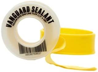

What thread sealant should be used on the sediment bowl to tank, gasline "elbow" to sediment bowl, gasline "elbow" to carb? I do have the Permatex product shown in the attached photo, but it is not clear to me if this is compatible to gas.
What thread sealant for radiator petcock? Could it be same as used for gasline elbows?

I use yellow Teflon thread sealing tape. Unlike white Teflon tape, yellow Teflon tape is for gasoline threads. You can order it from Amazon. Jim Patrick

The reality of the situation is that there really isn't a good thread sealant for gasoline parts. Yellow teflon tape is made to seal natural gas fittings, not gasoline. Gas versus liquid sealing is completely different. It will not resist.
As for the petcock, teflon tape would be fine there.

Sorry, yellow Teflon is for gases (like natural gas/methane), not gasoline.

Due to its chemical inertness, PTFE tape is resistant to both petrol and oil. Therefore, it is often used in automotive applications to seal and lubricate fuel line joints.
My understanding is that although it is designed for natural gas lines it is the best teflon tape for liquid fuels as well.

The only difference between yellow and white PTFE tape is the thickness.
