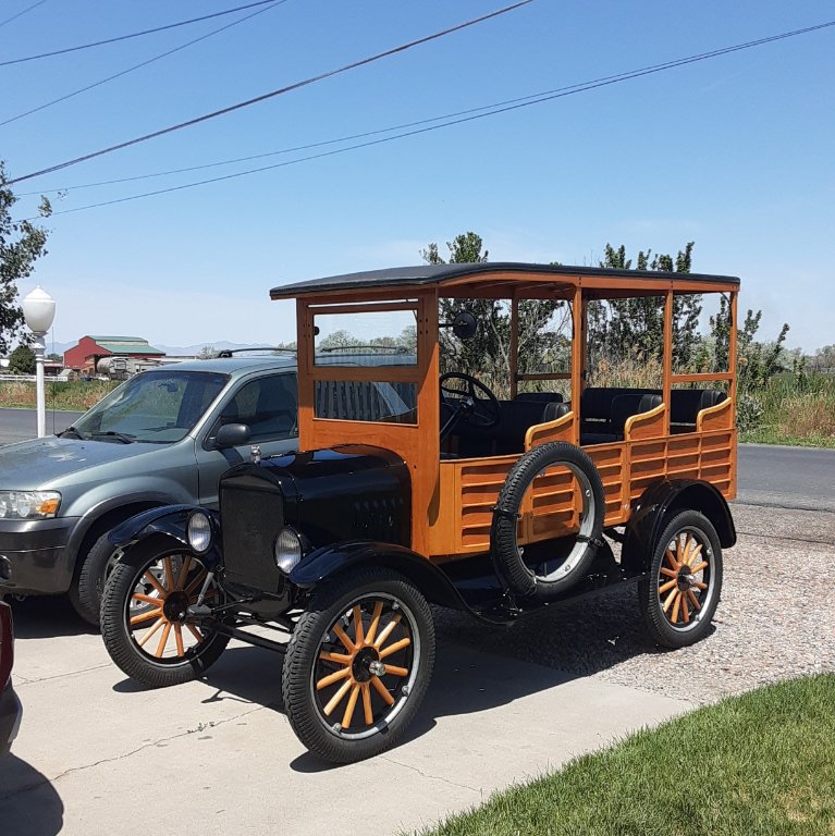

I too purchased as set of plans as well as the iron kit from Dale. I built the body for a '24 chassis. I found a couple of small errors in the plans and made a couple of changes for ease of building. Dowling the subrails instead of half lapping, and then I made the curved front panels differently. All in all no one can see the changes.
I have only seen one other original York body, it is in the Pioneer Museum in Minden Nebraska.
