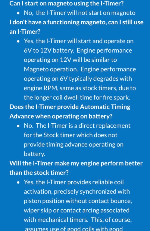

From Mike’s website
The I-Timer is 6-12v DC only.

Then here are the voltage requirements for the E-Timer.
