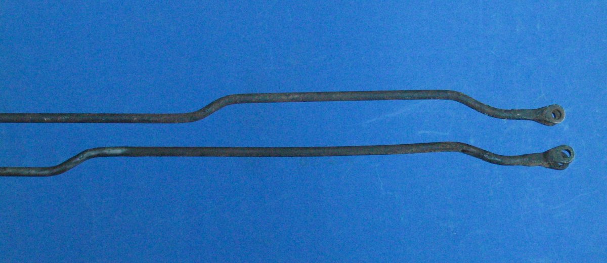

I haven't found a reference explaining the different lengths of the bends, but I assume they're for different years.
Both rods have the later forged ends. References disagree about the year those began. Both rods are 54ΒΌ" long.

Many times. I have the Seventh Edition, which does not specify the length of the bent sections, which is what I asked about (see photo). Updates on the MTFCI website do not give that information either.

I do not know of any reason why any standard model T would need or want the longer offset? There could be reasons surrounding some sort of auxiliary braking or transmission shifting system, or other special requirement needing a longer offset. Maybe to clear a power take-off shaft? Someone may have altered a standard one? Or a factory mistake on a replacement?
The improved (1926 and 1927) brake rods had no offsets, and were almost two inches shorter.
I have never seen one like that, and if it were mine? I would re-bend it to match the regular one.

The long-offset rod was one of two on my 1915. I never noticed that the offset was longer than normal, and when I did notice I thought it must be a difference in years. I suspect it may be what broke my left rod support. I've installed a rod with the shorter offset, and a new rod support. Now that I know that the long offset is wrong, I'll put a short-offset rod on the right side too. Interestingly, one of the rods in my parts room has no offset at all. It's early, not 26-27, as it's the same length as the others and has a cast fork. I'd tell you what years it's for, but the Judging Guidelines don't mention what year the offset began. Maybe not Ford?
