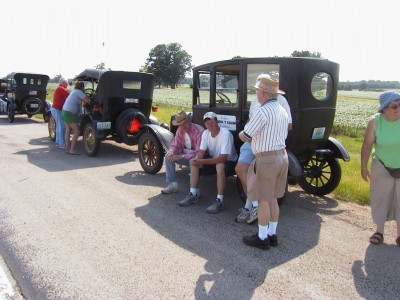

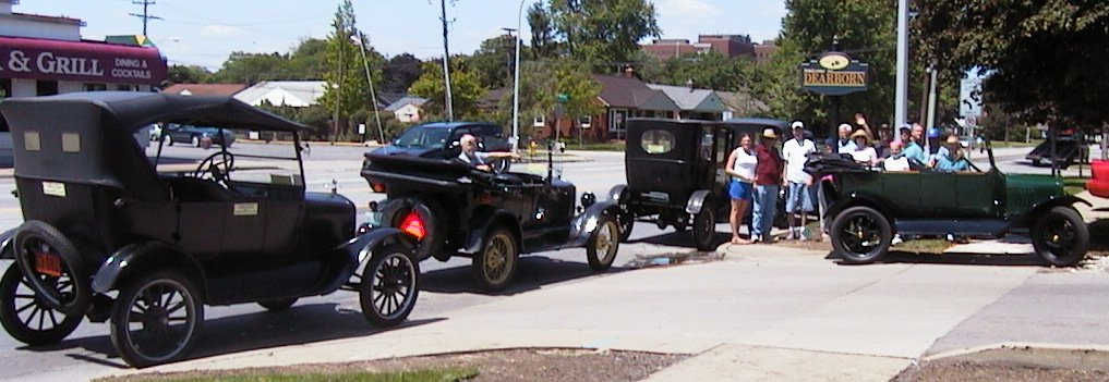

Cliff, I bought my Model T in 1996 and spent the first couple of weeks driving around the block (all right turns). When I finally drove a mile to the local library, I thought I had gone to the end of the earth. By 2003, when a member of our local club raised the idea of driving from St. Louis to Dearborn for the Ford Centennial, I was all in.
Seven Ts left St. Louis and three days later, the same seven Ts pulled into Dearborn.

Made it!

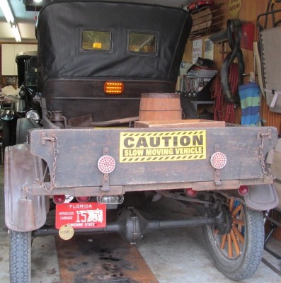

Follow-up to others on your planning, the Model T will do the job rather easy, when you are comfortable driving it and have the knowledge that all systems are functioning well. The T is reliable vehicle with good parts in order, and maintained.
The issue of today's drivers recognizing your T is running at much slower road speed is of caution to you of course. Many driver's aren't expecting a slow vehicle, some can't judge distances either, some are on cell phones anyway
So do add some attention getters to the rear of your T.
My T's have flashing lights in yellow, (magnetic attached) and big CAUTION signs (sticker or magnetic) for warnings, double brake lights, reflectors, etc... Many states call those Triangles for very low speed vehicles, under 20mph. Have never heard of another T'er being questioned by police on them, as in fact, the T when pulling a steep hill IS a 20mph vehicle
