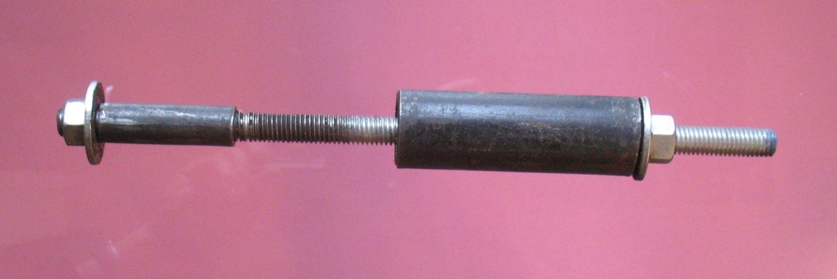

Bob: I had good luck using 3/8" threaded rod, washers and nuts, and a 3/8" drive deep well sparkplug socket as a 'puller' to draw the new bushing in while it forces the old bushing into the cavity of the socket. The cavity of the socket must be large enough for the o.d. of the old bushing to fit inside but small enough so the edge of the socket sits squarely on the arm. Alignment of the new to old bushing is critical, and it helps to relieve the outer 'corner'/circumference of the new bushing where it enters the arm. Bushing to bushing alignment is easier if you use a sleeve with 3/8" i.d. that fits snugly in the bore at the juncture of the new/old bushing. Once the new bushing enters the spindle arm hole the alignment is maintained. Oil liberally once you have things aligned.
Alignment on the exit side is important too so the old bushing has a clear pathway into the socket. This technique has been shown repeatedly for similar situations on the forum, so it is a familiar low tech solution. I would place the new bushing on top of the old in the arm, then insert the 3/8 rod with the alignment sleeve, top washers and nut downward and slide the socket up from underneath, place washers and nut on bottom, align socket, oil and wrench
Do not remove the spindle arms and I prefer not to beat bushings in/out even with the so-called 'drivers'. If you resort to a two step -- (1)remove old then (2) insert new, the threaded rod/bolt, nut and washer 'puller' to insert new one is still superior to beating it with hammer and 'driver'. (And from my experience, you will likely need to ream the new bushings slightly to get yolk bolts to fit arm bushings once they are installed.) Good luck, jb

If you have a press, remove the spindle. Use the bushing driver tool or equivalent in the press.
If no press, this threaded rod with spacers & bushings will do it.

Steve Jelf DIY bushing tool. Smaller tube OD same as bushing wall OD. Larger tube acts as an anvil large enough for a secure base but its ID needs to allow the bushing to slide into it. Adapt parts to fit your busing needs.
