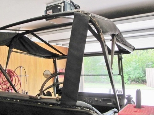

After wrecking the car almost two years ago I am finally in the process of installing a new top on my 1927 touring. My question is, does the long top straps tack to the #2 and #3 bows? The instructions that came with the top says to tack the straps to the bows, but on my old top, the straps were not tacked to the bows. There have been a couple other things in the instructions that I did not agree with and did more like my old top was installed. The top straps are all installed, and I will let them set for a few days to make sure they keep a nice tension, before I set the permanent tacks in place. So, it gives me time to see what the consensus is among everyone. This is the first "one man" top I have installed. I have installed a few of the two-man styles in the past. They are a lot alike, but I really like how the "one man" irons holds everything in its place. Everything is held ridged and where it should be, unlike the two-man tops that everything must be measured, and then held in place by the top straps. Ill post a photo of my old top straps. It will show that they were not tacked. I also believe my top irons and wood bows are original to the car. The wood bows did not have tack holes where the straps passed over them. Thanks for any info ...

Those two straps are to be stapled or better yet, tacked (tack head provide best fastening) to just the front and the rear bow.
If tacks are used on the 2nd and 3rd bow, the tack head will tear at the vinyl top cover. Have taken apart original '24 top, and the leading upper edges of bows 2 and 3 were fitted with felt strips to prevent wear of the top cover there. Modern fitting of top covers omit these felt strips, but then, we do things different than factory installers :D
Be sure those two straps are rather tight also, they provide the tension when pulling the top up and to the front bow locking brackets. So fasten the front bow to the windshield stanchions before you tack on the two strips to the front and rear bow, and then fit the side pads.

Thanks for the replies. I think I'm not going to tack the straps to the # 2 and #3 bows. It worked that way for years and as Dan mentioned that they may wear a hole in the top deck., I do not feel comfortable that the tacks would not work loose and wear a hole in the top. My top kit Is a Cartouche from Lang's. Overall, the quality is very good. Since my touring is a driver/tour car, the top will be plenty good for the use it will see. I'm OK with changes to the kit that don't show, but changes that do show bother me,when the kit manufacturer is selling them as "correct". Even though the two top straps are probably not correct, they are very handy to stick "tour maps" between the straps and top deck.

They are correct! These 2 top straps function to tension the front and rear bow when the top is up, and they perform the duty of supporting the top cover from rain pooling , and are very much needed!
Service Bulletin Nov '22 showing the 'new' One-Man Top, note the loose straps as they are not tacked to the middle bows, only the front and rear.

Dan, that photo looks like the "smoking gun" that the straps are correct. I also agree that they give more support to the top deck. I also just like the looks of them in there. Mine are installed and tensioned and are not tacked to the center two bows.
