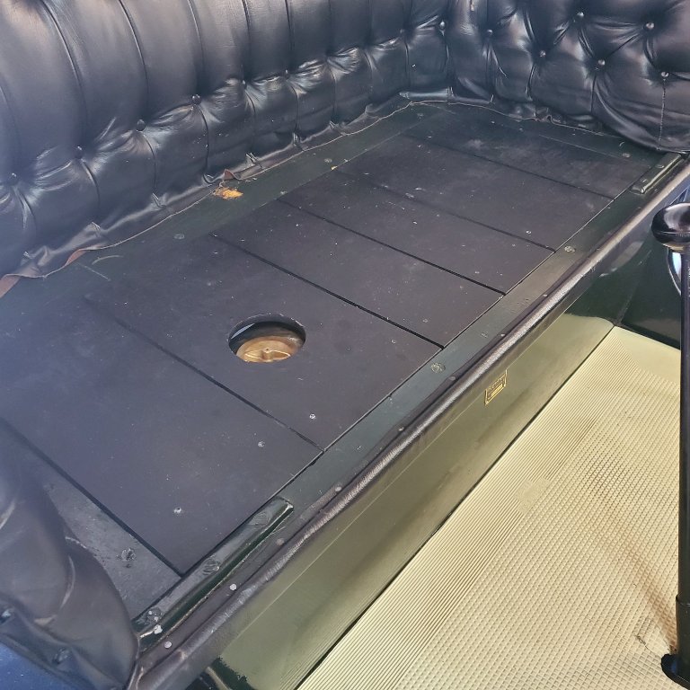

My when I was researching the same issue, I remember reading that the boards were sepate slats of random width running front to back. Under the boards ran two pieces positioned at 90 degrees to the slats a couple inches in from each end of the slats
The slats are nailed to the boards.
As you say, one slat has a round opening sufficient to unscrew the gas cap. I wasnt concerned about the type of wood used but chose a thickness for the slats to where they would sit flush with the frame opening when installed. Likewise I wasnt comcerned about the size of the opening just so it looked appropriate for what it was intended to be.
Since my 1912 is 30 miles away, I've included a photo of the cover on my 1910

Original 13 touring under the front seat. I can try to get you a shot of an original 12 touring but I am not close by where I have it stored.
