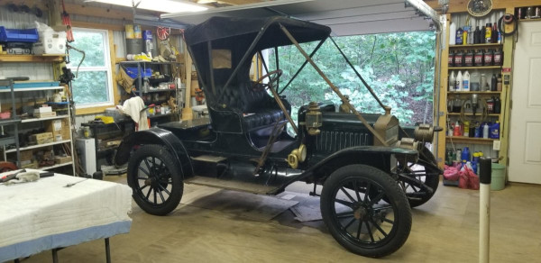

Brass windshield support rods... Is anyone making them?
When not playing with my 1913 or 1915 Ford's, I'm working on my 1911 Model Q-11 Maxwell. The car is very complete but it underwent an "incorrect" color restoration in dark green and black, back in the 1950's (It should be light blue). In any event, I have the brass windshield but the long brass support rods are missing. I figured Lang's made something for the 09-12 Model T that I could adapt, but saw nothing in their catalog or the website. So the million dollar question is: where does everyone get them? Are we left with making them from scratch? Your input would be appreciated.

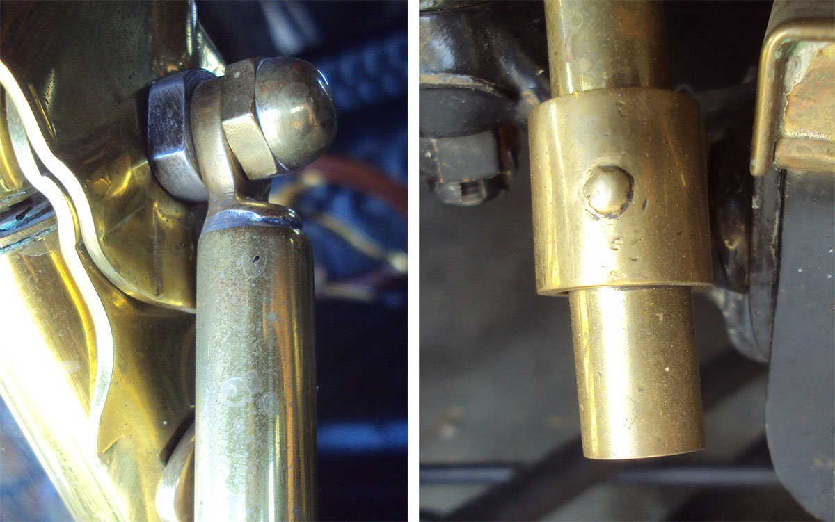

Mcmaster-carr is you friend. They have brass tube which can easily be made into windshield support rods. It is a ridged tubing that requires heat to bend.
Re: Brass windshield support rods... Is anyone making them?
I made mine from the thinnest tubing I could find. I made ends and soldered them in place. If I was doing it again I would use a bit thicker wall tubing and pin and silver solder them. I had do redo the solder and pin the bottom. The thin tubing vibrated some and sometimes made noise.

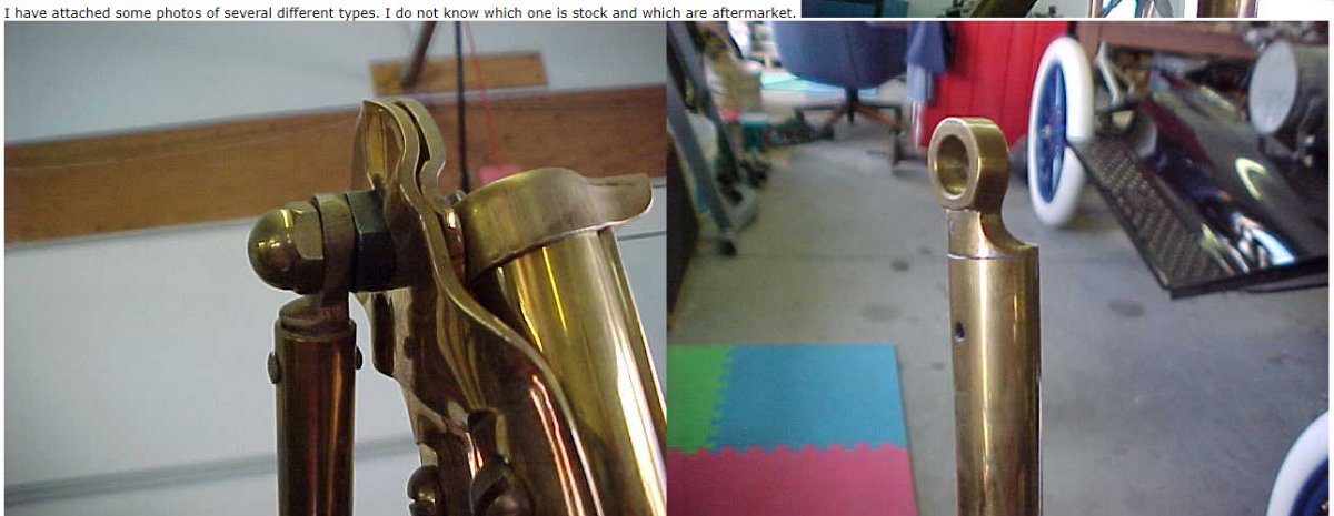

Rich Here are some of John Hatch's from this posting. http://www.mtfca.com/discus/messages/33 ... 1365628634
