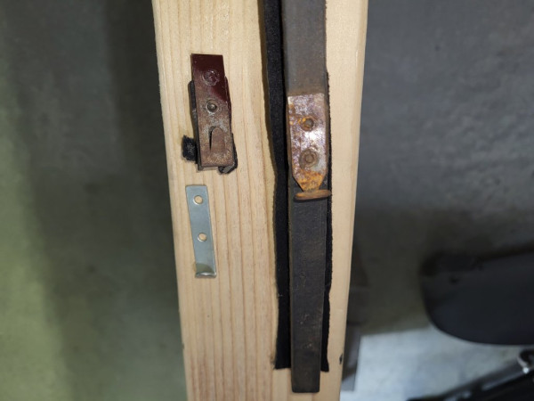

Jim, The felt channel was not riveted to the retaining channel on my 1927 coupe. It held in place by the clip at the top and the clip at the bottom that are shown in the attached photo. The was no evidence of any adhesive.
Some one told me that adhesive should be used. I had not intend to use any adhesive because it takes some time to get the felt channel hooked in at the top and bottom, and the adhesive is tacky enough to prevent the piece from being moved around while trying to get it hooked.

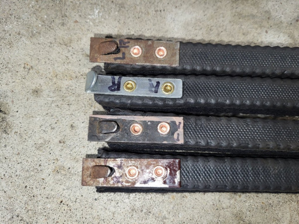

I have attached some of my clips using split rivets, but I ran out of them. After seeing your information, I thought maybe I should attach the remaining clips using hollow rivets or maybe replace the split rivets that I had already installed.
I looked up the McMaster information for size etc. and also the special tool needed to install them. The Tool cost is $55, so I guess I will stay with the split rivets!

I used hollow rivets as Jim Patrick recommended.
