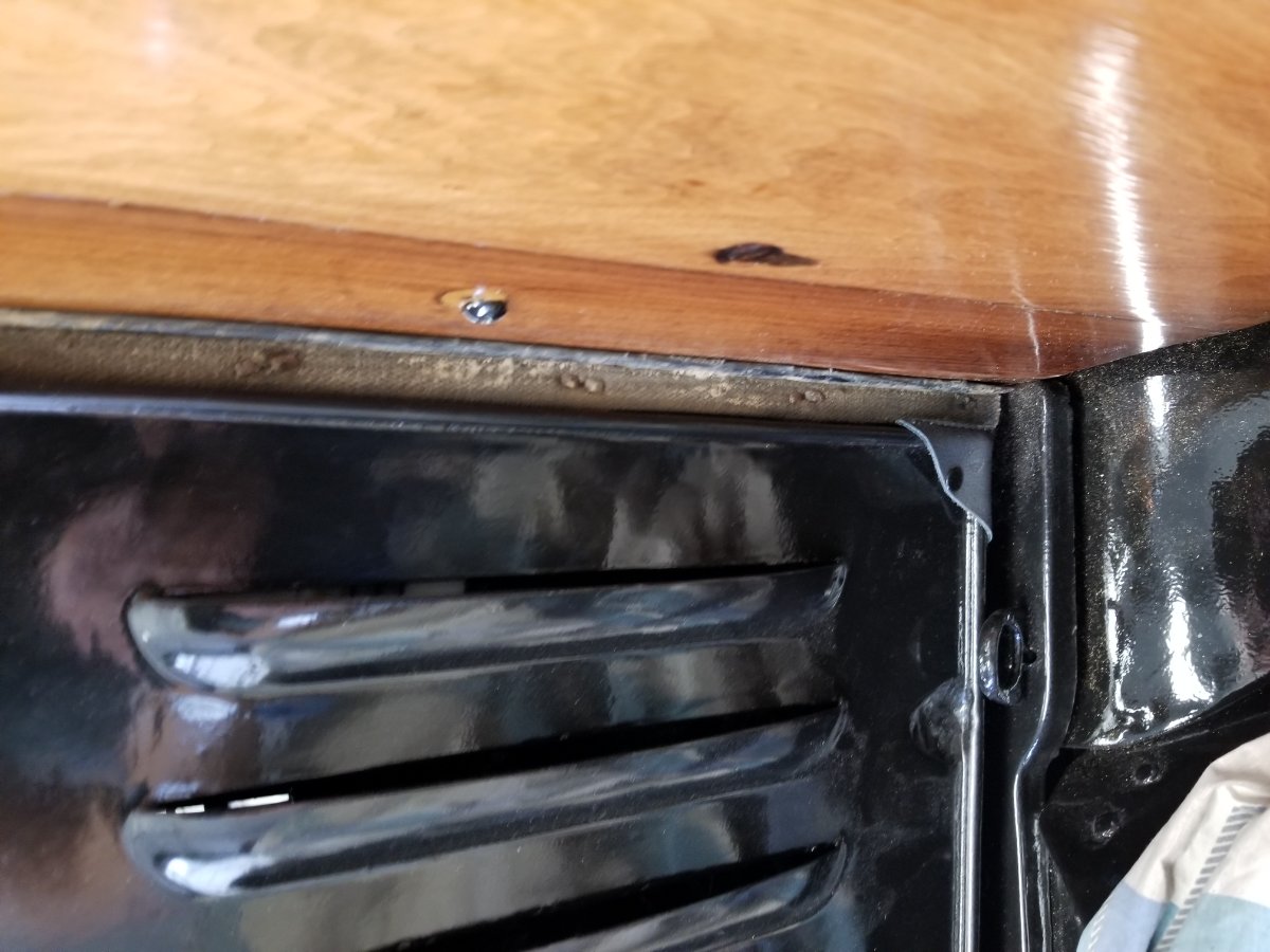

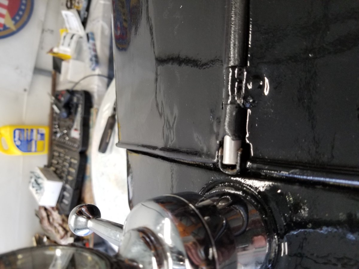

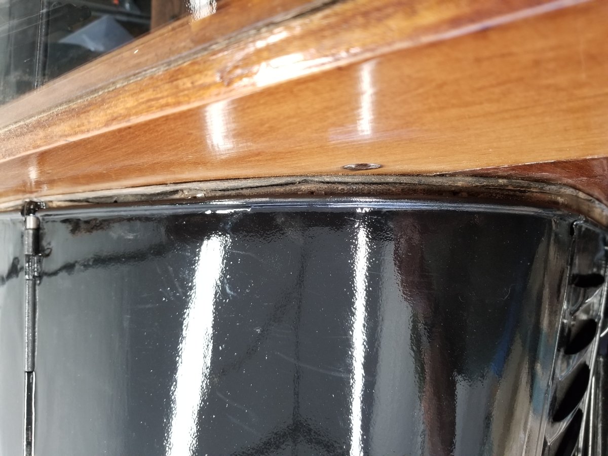

My hood doesn't want to line up with firewall. I've taken the radiator off at least twice before and never had this problem, unless I never noticed it. When I go to clamp down the side the curved upper part wants to buckle up. If I don't let it buckle up then there is an inch gap when clamped. We recently took off the wooden dash from the firewall to refinish it, but never touched the metal firewall. The other question, is there any trick to get the hood clamps from being so hard to pull up? I relplaced two in the rear with smaller springs but I didn't know if there is anything e;se i could do? If you click on pics they reappear rightside up for viewing.

Matt, your last photo is revealing. The hood is too far forward and that allows the fabric welting to show. The hood should cover this. The relief in the side panel into which the hood latch hooks is also too far forward in relation to the hood hook. A cannot tell from your photos what is causing this misalignment.
When you mention that the hood does not fit well if you pull the sides down and latch them, it most likely means the curves in the hood need to be played with to get the panels to more closely follow the firewall. This is easier to accomplish if the two side panels are removed . Then the curves can be altered by pulling/pushing the edges on some round stock such as a fence post, until they closely follow the firewall. The front can be reworked in a similar manner. Often overlooked is the bend just a couple of inches either side of the centre hinge.
Once the to panels fit, hopefully the side panels will be taken care of.
