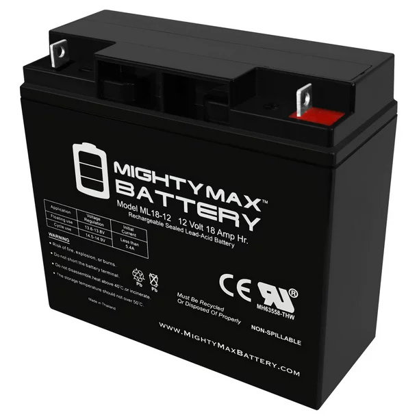

1915 non-starter runabout. 12 volts for LED tail/brake/signals, and coils only when starting. Phone/hot spot charging. 12v tire pump if needed. Magneto battery charger.
What do you electrical/battery experts think of this?
https://www.walmart.com/ip/ML18-12-12V- ... hbdg=L1700

The battery capacity should be adequate for your stated use, however both John and Pat raise valid points.
- It will assist the life of your battery considerably if it's correctly charged. Some of the magneto charger circuits I've seen don't have a regulator and will continue to supply current to a battery beyond the typical max voltage you'd usually want to use. While the current isn't high (so it's unlikely to result in a fire) it's not good practice, thus it'd be good to check your charger has a regulator and fit one if needed. Just to provide another view; with low current you can ignore it to some extent, but you'd likely need to buy batteries more often.
- A LiFePO4 battery would tend to have greater overall longevity and endurance in terms of rated discharge against a SLA as you show here. They're more expensive, but maybe a good option in the long run. As with SLA you should have a regulator on the charger, and given they're initially more expensive I'd suggest it's more important. Also while you can use a SLA charger with this chemistry it'd probably be better to tweak it to suit.

Yes its a battery you want & I want. It is "recharable" meaning deep-cycle, sealed and has 18 ampere hours (Ah) of power!Steve Jelf wrote: ↑Wed Aug 17, 2022 1:13 pm1915 non-starter runabout. 12 volts for LED tail/brake/signals, and coils only when starting. Phone/hot spot charging. 12v tire pump if needed. Magneto battery charger.
Its perfect since you have no starter. The load on your system with LED lights & coils is likely only <6amps so you could run 2 hours before thinking about recharging. Likely 6 weeks for just the coils to start it an no lights
Since the Magneto puts out voltages above the desired charging rate I would not use it unless you have a way to regulate that voltage. I used a solar charger/tender. I'm looking for one now...

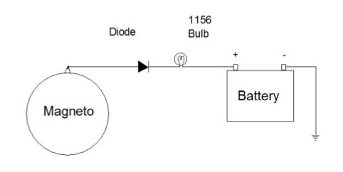

OK, that leads to another question. John's mag charger diagram specifies the 1156 bulb for a 6 volt battery. What bulb would be the right limiter for charging 12 volts?
https://dauntlessgeezer.com/DG102.html
What value or type of diode is used. Answers?

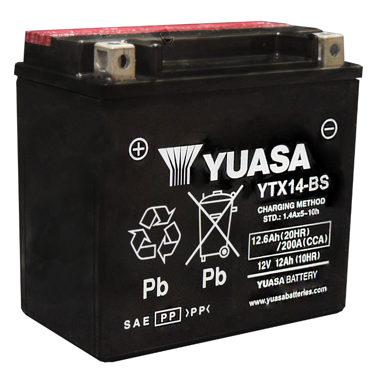

If you have limited room and limited height space, and your concerned about battery longevity and power, you can always put TWO or more of those batteries, side by side, and tie both + posts and - posts together. I used 4 of these 12 volt Yuasa sealed lead acid motorcycle batteries, under the rear seat of my 1915 touring car, because I had the room, and they are relatively short in height. I do not have a generator, or a starter, so the system is constant loss. I have LED brake and directional lights on the car and LED driving lights (just in case I get caught out at night) also. While the magneto headlights work well, for what they are, they do not reach far and do not illuminate much at low RPMs. I use a 12 v Battery tender Jr charger, and have permanently installed a quick disconnect harness with a plug and keep the car on the charger when not in use at home. It is simple and quick to unplug it before starting the car.
Because we run a GPS constantly, on T tours, and I start the car on battery, (immediately switching to magneto) is why I used 4 batteries. Might be overkill, but I have attended the Mississippi Cruisin the Coast event which is 11 days long, (nothing like having the oldest car on the street out of 30,000 attendees
) and never have even come close to draining all 4 down. I have had them in the car 4 years now. Everything works great still. This is the battery that I am using:

The above battery has less Ah (12.5) than the one your looking at (18). YTX14-BS is the battery size like Group 1 for a Model T boxSteve Jelf wrote: ↑Thu Aug 18, 2022 10:43 amOK, that leads to another question. John's mag charger diagram specifies the 1156 bulb for a 6 volt battery. What bulb would be the right limiter for charging 12 volts?
Its my understanding that the bulb was intended to act as a resistor.
But it may be a better battery than the deep-cycle since you will be continually charging it. To prevent over charging you could put a Voltmeter gauge connected in parallel to the load (bulb) to monitor the voltage - then to drain some off turn your lights on now and then
Looks like you have hit upon a solution, searching http://www.mtfca.com/discus/messages/29/23876.html
By John F. Regan on Sunday, January 21, 2007 - 11:32 am:
You can use the same bulb but you will get less charging using a 12V battery because there is less potential difference between the nominal 28VAC of the magneto and the 12V battery versus 28VAC and a 6V battery. If the battery is used only for hot shot starting and possibly powering a brake light then the bulb we supply in the kit probably will work fine. If you need MORE charge then you can use an 1129 bulb (which is a 6V bulb actually) in the circuit with your 12V battery. You cannot use an 1129 bulb to get more charging with 6V battery since it will burn out rather quickly. The bulb we supply in the kit is an industrial bulb that is about the lowest resistance bulb we could find that was 12V. Everage charge rate will also be reduced if you are running a 3:1 rear end due to lower average RPM of engine.
Its been many years since I had to think these things, so fwiw
I believe the bulb is to act like a variable resistor as the magneto spins faster and more voltage the bulb gets brighter = more resistance and then less voltage out V = IR

The bulb does act as a variable resistor. When the bulb filament is cold, it has a fairly low resistance. As the filament gets hotter, its resistance increases dramatically. A partially discharged battery has a low resistance. As the battery is charged, its resistance increases, assuming the voltage applied to charge it is constant. Trouble is, the voltage from a Ford magneto is not constant, and it is often well above the nominmal voltage of a 6 or 12 volt battery. When the voltage applied is higher than the nominal voltage of the battery, it will force current into the battery even if it is fully charged. This causes problems. The bulb as a regulator is far better than nothing, but it cannot match the magneto voltage to the fully-charged battery's float voltage, so overcharging can still occur, especially with a very small battery. As the battery comes up to full charge, its resistance becomes high and the bulb will get dim. This lowers the bulb's resistance and allows the voltage applied to the battery to rise, which can result in overcharging. A larger battery is much less susceptible to this, but it can occur, since the magneto voltage is often well above the battery voltage, and the dim-lit bulb and high resistance of the charged battery do little to reduce it. Current is limited, but voltage is not, so charging will continue even if the battery is fully charged. Using a lower wattage bulb will further limit current, but average charge rate will be reduced, and the system will still not be able to respond to a fully-charged battery. How bright the bulb is glowing can give some indication of the rate of charge, assuming the observation is made at a specific magneto output voltage. Assuming the magneto is delivering, say, 20 volts, a brightly lit bulb would indicate a high charge rate, which would indicate a low state of battery charge. A dimly lit bulb at the same magneto output voltage would indicate the battery was at or near full charge.
Topic author - Posts: 7413
Re: Is this battery the one I want?
Thanks, Frank. I will put the 1129 bulb on my shopping list.

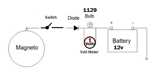

Another idea is to incorporate a voltmeter and switch into the existing magneto charger. That way you can manually observe what's going on and manually regulate it. Once the car is started there is no need for the battery to be charged. The buzz coils on starting don't take much of battery power. When you turn on the lights, flip the switch to on. I don't think the battery type matters starter or deep-cycle with this other than a starter battery would get more frequent charging of shorter duration to top it off, while the deep-cycle may like less frequent but longer charging time since it is designed for that.Steve Jelf wrote: ↑Thu Aug 18, 2022 3:05 pmThanks, Frank. I will put the 1129 bulb on my shopping list.
(And thanks to John Regan.)![]()
Rule of thumb for estimating charging time is based on the charger rating and battery capacity. For a 10Ah battery and 1 amp charger 10 hrs, same battery and 2amp charger 5 hours
- Attachments
