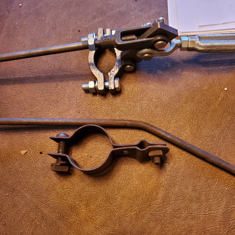

For those interested, here are photos of an original AC linkage.
Mc Eacherns reproduction is present in some of the photos.
tachment]

20220515_184012.jpg[/at[attachment=3]20220514_173030.jpg20220514_172950.jpg20220514_172940.jpg20220514_172913.jpgtachment]
Much appreciated Mr. Gould! Those are some great shots!
