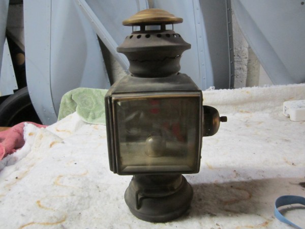

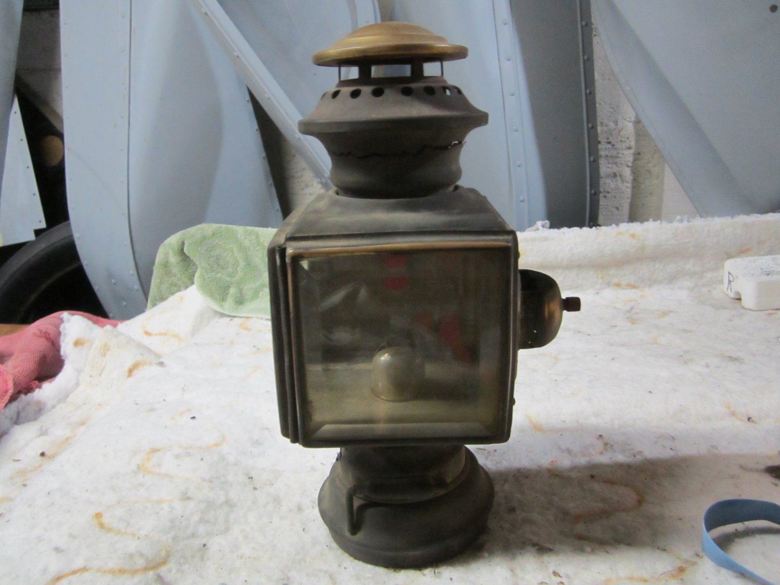

Does anyone know who restores brass side and tail lights. These are two tier made by the 'Indiana Lamp Co, Connersvile, Ind'. While I have a 1915 Model T Runabout, these lamps are off my being restored 1911 IHC J-30.

Same posting on the AACA Forum. I responded there, but recommend you restore them yourself. I added the video of brass sidelamp restoration that was dome for Model Ts some time ago, and these Indiana lamps are not much different. I'm still wondering if they are part steel/brass or all brass. From the pics it looks like they could be that type, which might make restoration a bit easier. It's not too hard to do them. Disassembly for plating the reflectors is pretty simple. Reassembly can be tricky but all the glass looks good, so I'd say make it a project.

Your lamps don’t look too bad, just a good polish and they will look 100% better. I bought a couple at Bakersfield and each took about six hours to get looking good, so if you pay it will be expensive.

Thank you again to all who responded. The lamps are actually quite brittle, they were on the car in a barn from 1921 to 1991 with wide swings in heat and humidity, and have some serious cracks. The headlights were in much better condition and I did get them restored. I have a long way to go on the car and need to start saving for the eventual need of paint, a top and upholstery so the lamps may have to wait. I do have appropriate E & J's and IHC used E & J's also. The IHC J-30 was a 40th birthday gift from my wife. A true barn find. I was supposed to have finished the restoration by my 60th birthday. I'm now 67 so maybe by my 70th? My attention now must be on my 1915 T Runabout for an upcoming tour. I have only driven the T in town and now looking at putting many miles on it. A new adventure.

Glad you provided a bit more information. If your lamps suffer from "serious cracks" as you state, then I'm afraid there isn't much you can do to them. Some cracks can be silver soldered and then buffed to blend the repairs in a bit, but they will soon crack some more. The only thing that can be done is to make new parts and that's probably where a professional restoration would be your best (and perhaps only) option. My recommendation is to find another pair - Indiana lamps are not that difficult to find, and I've even seen the IHC script on top at Hershey. If your tops are decent though, they could always be swapped onto a pair of plain non IHC lamps.
