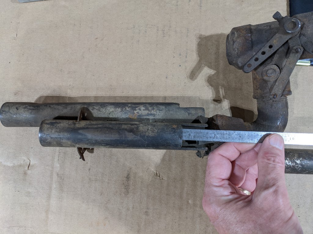

I have an Aermore number 2 that is missing it's longest tube. Does anyone have the overall length of the tube? I can make a guess but it would be out of tune.

Mark, the short answer is 13” for your particular exhaust horn.
Fulton/Aermore was inconsistent through the years, and there are short No. 2 horns/whistles and long No. 2 horns/whistles. Yours is a long and has 1-1/8” OD tubes. It is the same in both tube lengths and diameters as most No. 1s. The short No. 2 has 1” OD tubes, the longest of which is 11-1/4”. The long No. 2 and No. 1’s OAL is about 14-3/4”, and the short No. 2’s OAL is about 13”.

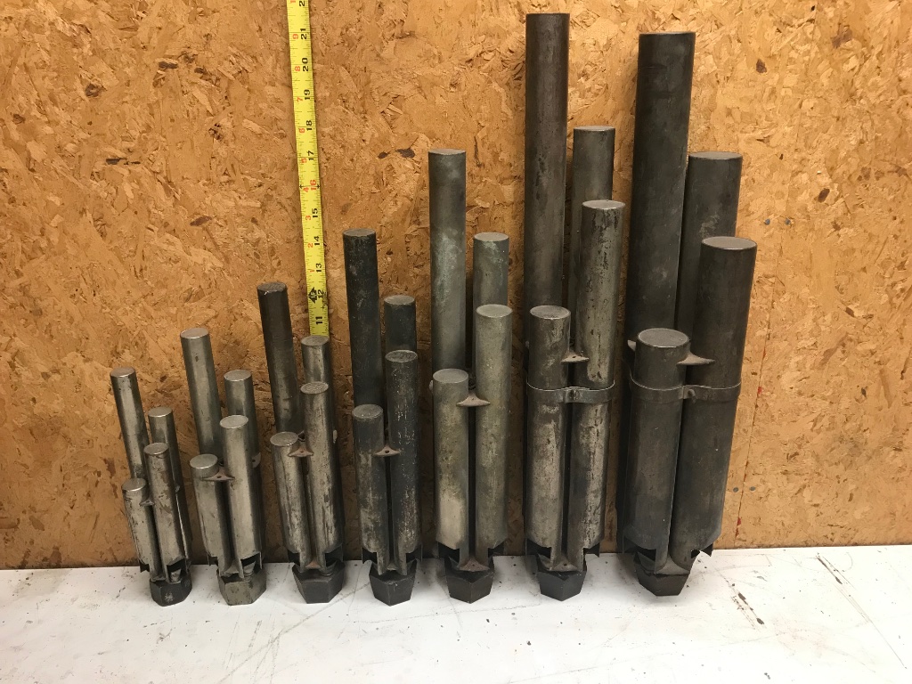

This photo shows what I believe is every size, with the possible exception of the 8” OAL motorcycle whistle if they ever made it. It is listed in some advertisements, but I haven’t come across one. They are probably out there somewhere. Generally, the size listed for the T was the second from left, an 11-1/4” OAL whistle, which is sometimes listed as a No. 3 (not stamped as such that I’ve seen). Later, they began listing the No. 2 as the size for the T.

by RajoRacer
I believe I have the 8" motorcycle one - I'll open up the showcase tomorrow.
Re: Aermore exhaust horn tube length
Posted: Tue Sep 06, 2022 7:37 pm
by namdc3

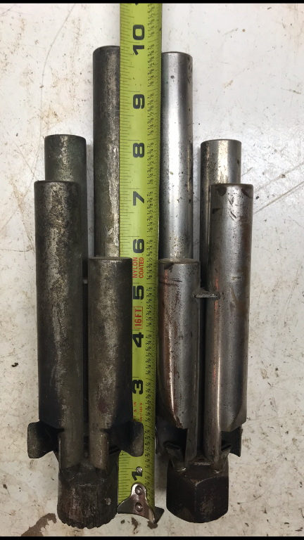

Steve, last we emailed each other yours was 9-1/2” OAL, which I suspect is the 10” motorcycle version. The advertised lengths vary somewhat from the actual lengths. This photo shows two that I believe are 10” versions. While yours is slightly shorter than these two, I would expect an 8” to be just shy of 8”. You gave me your tube lengths, too, and they match these. I’m don’t truly know, though. Clearly I’m in the market if one should arise.
