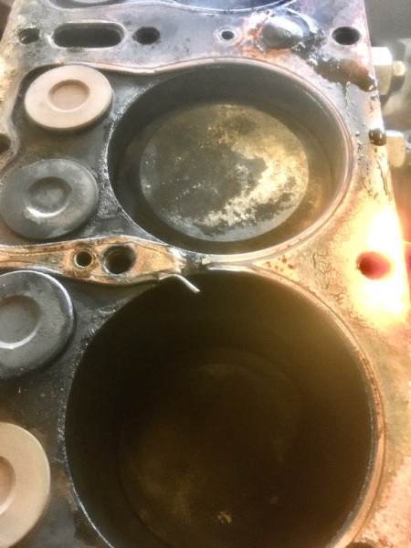

I had that happen to my 1927 last week. It was such a convincing knock that, combined with mag, starter and generator issues, I pulled the engine out.
I quickly found that the lack of power and sudden knocking turned out to be a blown head gasket. It is worth either a compression test or pull the head off first.
My gasket blew between #1 and #2. I found the deck was ok but the aluminum Z head is warped. .008” between 1 and 2, 2 and 3, 3 and 4. It is going to the machine shop tomorrow to get decked flat… again!
Head gasket “knock”
Head gasket “knock”
It’s easy to check for this problem before pulling the engine if there is no other problem.
The obvious thing I heard but didn’t understand was the “knock” was loudest near the muffler!
The knock was so convincing I checked all 4 rod bearings (all perfect) before finding the head gasket problem!
