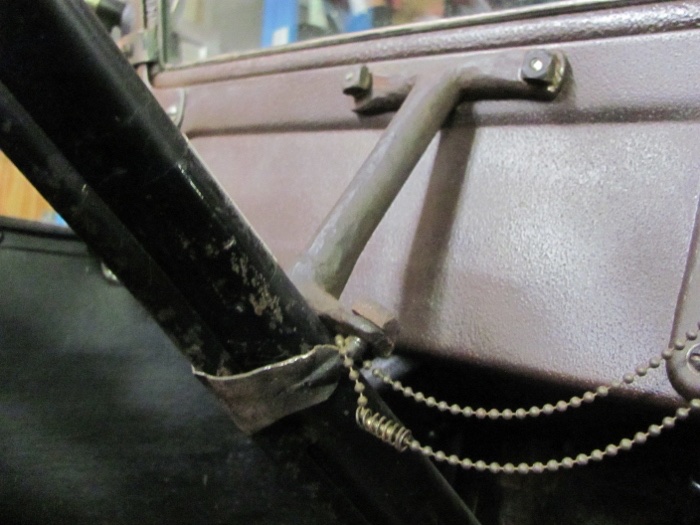

Here are some original accessories used prior to Ford making it's version.
Ford bracket used beginning early spring 1923.
IMG_1832 (640x480) (2).jpg (84.72 KiB) Viewed 2384 times
Nellie, my early '23 Cut-off, with steel firewall didn't have the bracket, as it was built before the new dash panel bracket. So found this 'home forged' bracket at Chickasha swap, the ole farmer heated up the forge, and split and bent this iron piece. The surround metal part is from a speedometer bracket he used! Crafty folks back then!
