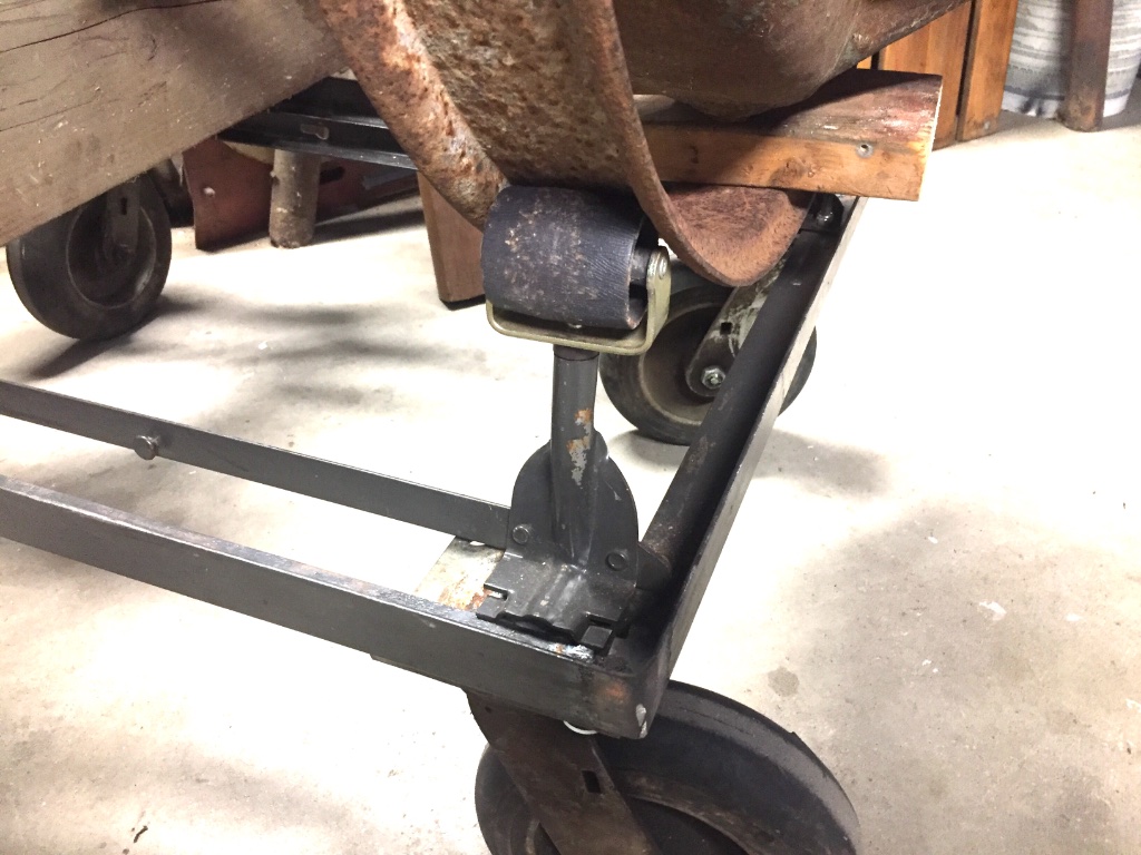

I appreciate everyone comments. I can see the advantages of using an engine stand modified for a Model T. I can also see how a nice run stand is useful if a car is not available to test the engine.
My main purpose for this engine stand would be when I find a spare engine that hasn’t been ran for a long time I could work on it doing basic things like adjusting the valves or perhaps even removing the camshaft two a ream a valve guide or change the piston rings.
I might be stubborn, but I decided to give my idea a try. A neighbor was throwing out a bed frame, so I decided to use it for my base and even found a purpose for the casters!
Here is a progress photo:
Here is a mock up of the rotisserie engine stand just to see how things are fitting together. Obviously the boards would be removed the engine would be connected two brackets welded on the rim. I have some ideas for the front of the engine still gathering parts for that.
One of the benefits of using a bedframe on this project is that I am learning how to sharpen drills on my vertical belt sander. :lol: Bed frame rails are very hard. I start with an 8th inch drill in the step up to more steps. I’ve had to sharpen the drills multiple times for the dozen holes I drilled. I welded the base frame together. I attempted to notch and bend the frame but it would crack, so I had to heat it with a torch to bend it. Fun stuff. I figure worst case scenario it will make a good base for a run normal engine stand.
I appreciate your comments and suggestions.
Matt

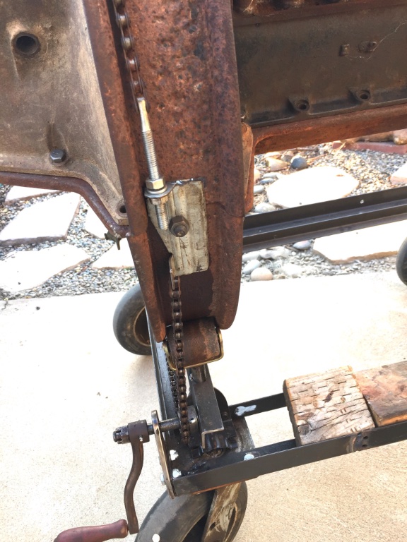

Here is an update on my progress. I did attempt to find a way to make the engine more balanced, but decided to just keep it simple.
Easy to invert the engine.

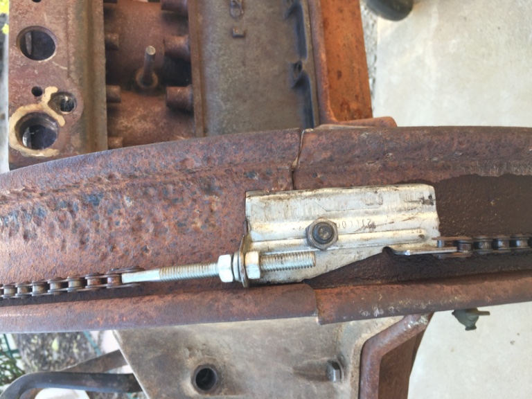

Hand crank mechanism consist of chain that I got from the garage door the mechanism and a crank handle probably from old grinder. The chain looks to be about the same as a bicycle chain. The gear ratio seems perfect as it is not difficult to turn.
This is the part that connects the chain to the door. It worked great to tighten the chain.
As suggested I use a bolt to lock in position. I will drill more holes when I determine where I want to lock it.
This has meet all my goals. It is light weight and could easily be transported in the trunk of my Saturn. And with the large wheels I can easily roll it over large rocks and gravel in my back yard.
I am still testing it, but like the results that I am seeing. There is still work to be done to run a engine on it.
Matt

I appreciate everyone’s feedback.
Charlie, I agree that an engine stand that attaches to the block and holds it vertically is ideal for assembling an engine. The idea here is a run engine stand that rotates. I was wanting to build a run engine stand that is versatile.
Mike that sounds like a good idea when adjusting rod caps or initially running a engine.
Matt
Re: Run engine stand that rotates- want to see what you have before I build mine
Posted: Sun Oct 23, 2022 1:22 pm
by Dan McEachern
One suggestion on your chain- one wrap of the chain will limit your rotation to less than 360 degrees. You might consider two wraps of chain that will allow you to go all the way around with no restrictions.
