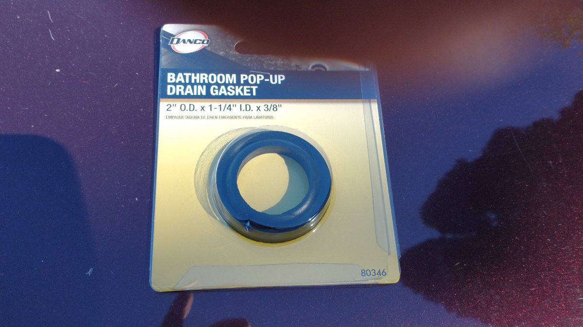

I buy these at any hardware store. I think they work better than the gaskets.
I assume Art and Norm use one similar.

Re: Shimming a Motometer

YES, These work very well.

There it is Dave! I didn't remember what it was for.
Works just right here too. A slight compression that I always worry about but the dog-bone never moves.

I just went to my Home Depot and bought two. $1.88 each. THANKS! bobt
