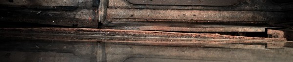

It was straight forward until I got to the steel panel which holds the window mechanism where I found two nails holding the panel to the pillar.......

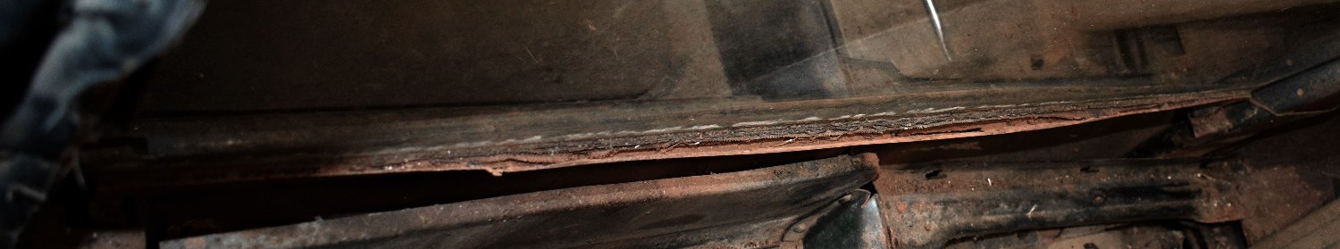

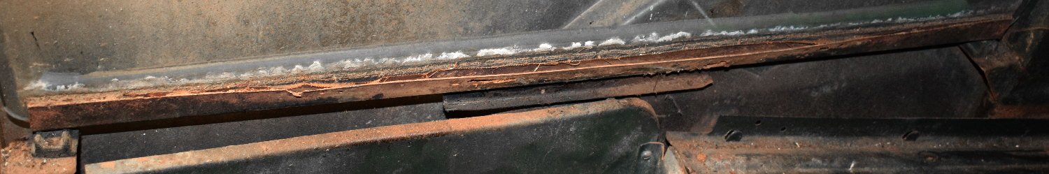

So this is what I found.
Rust has pushed out the window channel which wedged on the lifter and that was that.
I'm going to clean out the channel and bend it back as I'll probably never bother with either rear window again.
