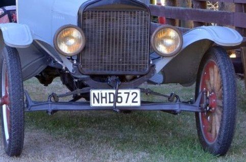

Bracket in use:

A Whiteman wrote:
Tue Oct 18, 2022 4:47 pm
Bracket in use:
Again this is a later T.
The motor mount for a 16 is very different making the license plate mount very different.

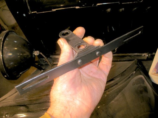

This is what you need. Its designed to use the front spring clip ubolts on each side of the crank. The picture has them resting face down

I don't know who originally posted this picture of brackets to mount a license plate. Note: the brackets curve back at the bottom so the crank will clear the plate.

The brackets dont come bent back. As you imply, it might be necessary to do some bending to clear the crank.

The reproduction ones that TRDxB2 (Frank B) shows are too lightweight. I wouldn't trust them. I have seen a few originals and the steel was nearly twice as thick.
I make my own. Some lightweight 3/4 inch angle iron. Cut the shape on a steel cutting band saw. Drill the large holes where they belong and a line of under quarter inch holes located to fit up the license plate. About five minutes with good files makes the line of holes into a good looking slot. One could save some of the effort (I like for it to look like the real thing with the slot), and simply drill single holes to hold the license plate. One could drill two sets of single holes? One set to fit the antique plate? And one set to fit the modern plate in case it is needed at some point?
Don't want the thin steel to lose that antique license plate!
