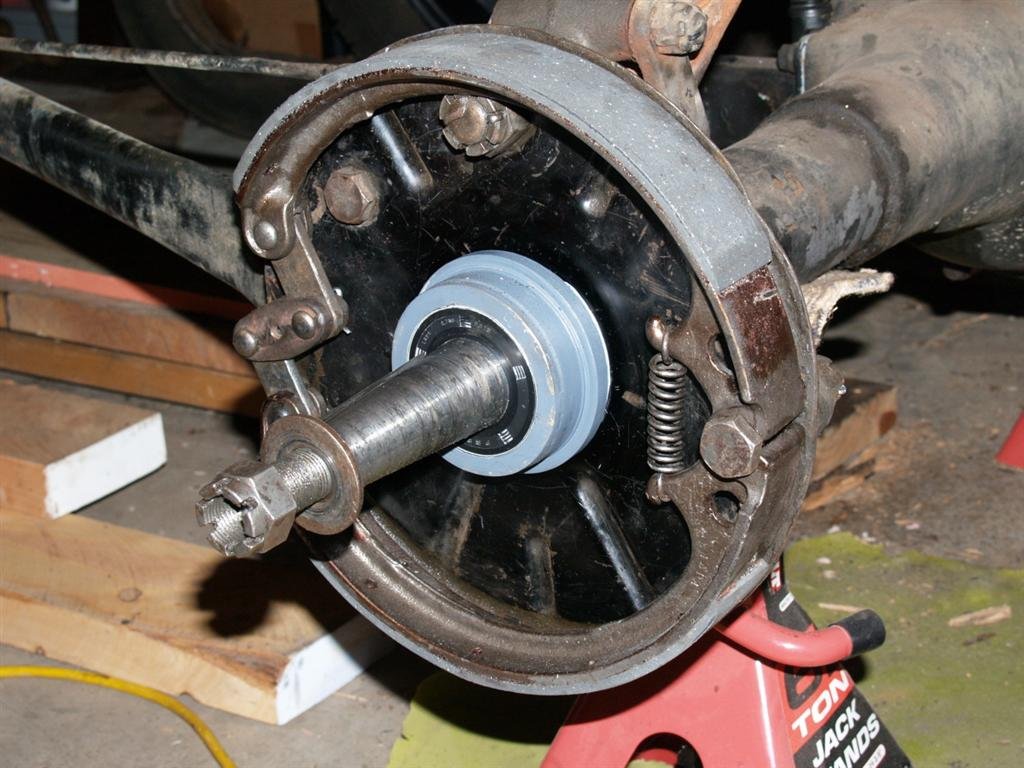

Well, a picture is worth a thousand words. The position of the cam and links is about per this picture. Left and right are the same - i.e. the cam 'leans back' on both sides, and top link angles back as well. When the rod pulls forward it pulls the cam and expands the shoes.
(the grey painted seal carrier is home made - works fine :-) )

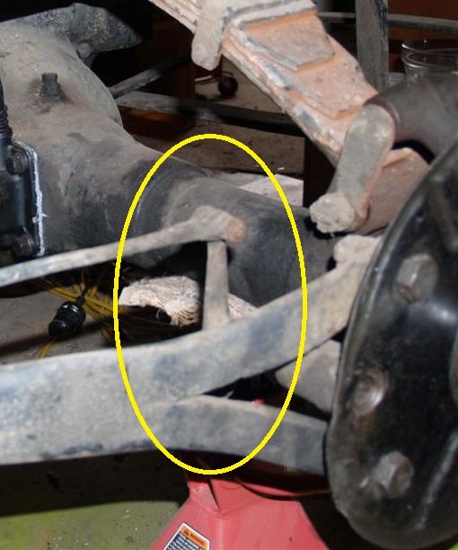

The lever should be vertical like this: The teeth at the end of the lever allows some adjustment (see Martynn's diagram): https://mtfca.com/phpBB3/app.php/gallery/album/59
YOU MAY BE ABLE to adjust the lever so it 'leans back' a little if your rods are a little too long. Don't lean it back too much or you lose leverage.

If that is YOUR photo, THANK YOU for posting it. I used that exact photo to remedy my problems on the driver's side and check the passenger's side, which I had backwards as well. That leaves just one alternative: Pull the right side wheel, remove the shoes, and grind down the lining a bit.

"straight up" bellcrank should be when the brakes are fully engaged, and when released, the bellcrank should be laying backwards

Lever up or back - just so that it is not forward, in such case you lose leverage. Mine are leaning back a bit when 'off'.
You may have to adjust the lever as the shoes wear (hence the toothed design).

I thought, at first, the upper shoe was hitting the spring perch nut but it wasn't. Thus, I had to look farther. Moving the actuator lever, it would hit a hard stop in one direction and hit the radius rod in the other. Finally found the spot. I ground the ends of the links round, just taking off the points of the 45 degree angle cuts. Reassembled and everything works great now. Take a close look at Adrian's photo, specifically, the connecting links: They have round ends.
