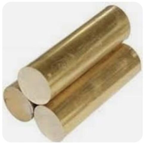

I am making an adapter out of a piece of 1" x 1-3/4 long brass rod , 5/16 hole drilled through , then tapped 1/2-18 on one end , and 1/8 Pipe on the other end , so I can screw it on my fuel bulb with a 1/8 Pipe x 5/16 Barb 90 degree and use 5/16 rubber fuel line , a 5/16 inline Fuel filter ( let's not argue the merits or not of that ), then onto 5/16 steel line with bubble flares to slip the rubber fuel line on, and at the carb a 5/16 double barb fuel shut off into a 5/16 barb x 1/8 pipe 90 degree......
the reason is , A) need to replace the old nasty copper line B) Not keen on the felt packing, or using a section of rubber hose as a packing material , brass compression ferrules don't belong there , C) 5/16 line and 1/8 Pipe fittings are all 5/16 internal diameter which is better flow that 1/4 inch fuel line , which May or May not have bearing on whether or not an inline fuel filter will or will not starve a Model t of fuel .

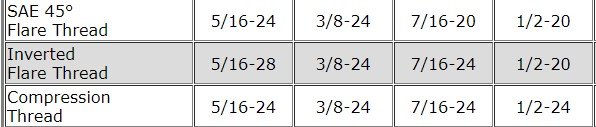

5/16 tubing uses 1/2-20 and 1/2-24 depending on what type of flare:

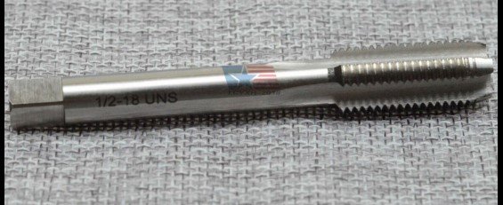

There is more to a thread profile than simply pitch. Witworth threads are 55 degree, UN threads are 60 degree. You may also be surprised at the size of 1 Whitworth, approximately 1-5/8”
I am impressed at the amount of effort that the OP went thru to find an off the shelf tap in this size, but sometimes tools simply need to be custom made. Most any lathe will cut just about any thread pitch, regardless of diameter, and so a little effort can save the cost of custom tooling. Many folks fear cutting internal threads on a lathe, with a little practice they are just as easy as external threads. You can always try running the spindle in reverse so that you are not threading to a blind stop
That one is beyond my scope of training or budget , but yes, if one were a machinist and had the time , money, tooling and knowledge , that would be a good solution. At one time my 87 year old Dad could have done it, buy age has caught up to him . Sadly , as folks get older and die off, we have lost great resources .
