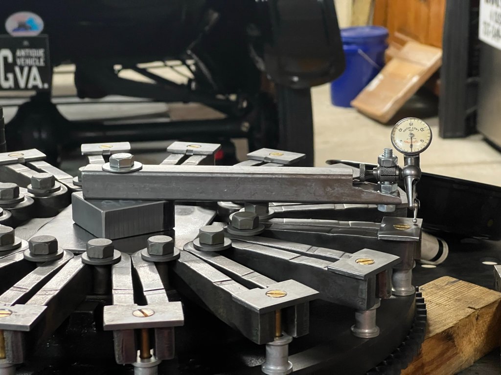

I've been reading the tons of posts on the forum about setting the brass screws for the magnet retainer plates. Folks discuss having the plates all in the same general plane and within a certain tolerance of each other in that plane. I've seen where folks say not to tap down the plates to adjust heights because of killing the magnetism of the magnets.
With mine, I have all new retaining plates, screws, and spools. The magnets were recharged.
I made a rig to see whether the plates are at about the same height
But when I ran the dial indicator over the pieces, I was surprised that there was a 'slope' across the plates.
I'm guessing this is due to the magnet thicknesses. This can be quite the difference in height too. I decided to take some time and went around the set of plates and measured the height from the back side of the ring gear to the top of the plates (on both sides) and found that these have a big difference in some places (or what I feel is a big difference)
Is this something I should be worried about and if so, how do I fix it? I tried sanding/grinding off one side of a plate for S&G. Is that a bad thing to do?

The new plates aren’t really made right. You are better off using good used ones.
Re: Magnet Retainer Plate Level on Flywheel
Posted: Sat Nov 12, 2022 10:44 am
by Scott_Conger
because it's set by clearance, you obviously have to set to the highest or closest gap on each one when shimming the spools (at least I shim the spools, and others do, too. Others just smack the things to set the height of the magnet through compression of the spool and maybe level the keeper in the process). It is the most annoying job there is on a "T", in my opinion.
you are also going to find some variability across the magneto ring pole faces...funfunfun!
If you're using new keepers, think about this: I've found that new keepers are very soft and prone to warping...old ones are cheap and far superior
you're finding out why some folks go to extra lengths to match magnet thickness, etc.
good luck, and remember the hobby is FUN! (Keep repeating this)
Posted: Sat Nov 12, 2022 11:22 am
by speedytinc
I measure the thickness on the spools, magnets & keepers & try to mate for even height. Real shorts I might add a .010" shim washer.
Heights still need tweeking.
To adjust (lower) the height I use a big C clamp with a thick hardened washer as a spacer to protect the screw on the back side. I have broken a few aluminum thimbles. Goes with the territory I guess.
Yes, its a pain & time consuming job. I dont mind for my own motors. Yea fun.
Posted: Sat Nov 12, 2022 11:30 am
by ABoer
Max ,I turn down the Support Spools if they are to high .
And always use old plates .
Toon

I spent a lot of time matching the magnets, spools and plates. In the end, the plates are within about .002 inches of each other. I set the minimum air gap at .020 in. After 8000 miles the engine starts very easily on mag by hand cranking.
Some people randomly assemble the pieces, then true the surfaces in a lathe.
Posted: Sun Nov 13, 2022 12:47 pm
by MadMax
I would think that if you machine the whole face, you would have to disassemble everything, clean, everything to make sure that all of the grindings and shavings are gone, then reassemble it.
Because of the variety of magnet thicknesses, I would think he would have to map all of the parts to make sure you put them back in the same place.
For those of you that have done that, is that the way you handled cleaning it or is there another way?
I believe machining the face of the whole assembly is overkill. Using shims I get a variation among the plates of less than .005". I call that good enough.

I parted the flange off a worn shaft so that I do not have to work around that obstruction. It makes it easier to work on the flywheel on a bench.
Posted: Tue Jan 24, 2023 5:13 pm
by RajoRacer
That's what I posted a few days ago !
