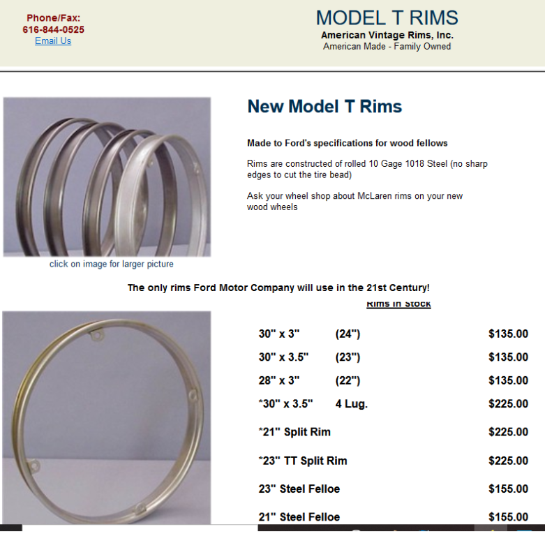

I believe that Mike Lebsack is making the wire wheels - what else ? https://www.mtfca.com/discus/messages/7 ... 1486822092
Mike Lebsack in now producing the wheels.If your interested, 319-430-4995 You can also tex to this number. Vintage Wire Wheel 802 Ryan Ct.Iowa City, Iowa 52246 He also offers a 21" speedster wheel with spinners
From the Internet
American Vintage Rims http://www.americanvintagerims.com/
McLaren Wire Wheels old web site no longer there http://www.mclarenmfg.com/
Listing in Lang's
