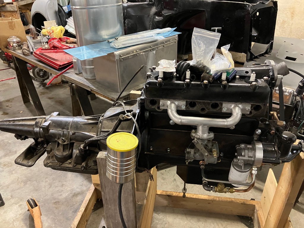

by Les Schubert
Getting engine ready for installation!

Les i would like to know more!

by Les Schubert
Pressure oiled counter balanced crank
Datsun B210 oil pump
Pruss head
Stipe cam
Marvel Schebler carb on home made manifold
Borg Warner T35 automatic from a 68 Cortina
Cast aluminum adapter by me (I no longer have the pattern)

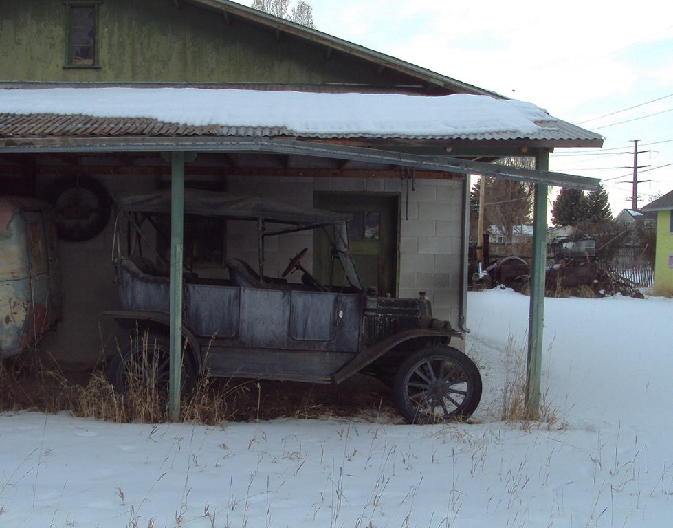

Posted: Sun Dec 11, 2022 5:49 pm
by Rich Eagle
My condolences too. By all means, give it some time. Things often get brighter.
Today I bit the bullet and rescued the battery from the snowbound '14. I have left too many in the cars without charging during the winter and they died. I charged 3 of them today and they reached full charge quickly.

by frontyboy
1914 roadster,
Engine out, installing new rods, adjustable lifters and valves, new timing gears, starter mag ring, rebush transmission, new bands, new clutch spring, new Z aluminum head and rebuilt straight thru Holly carb. Also installing a new gear reduction starter and converting to 12 volts.
Next will be disc brakes.
That should keep me out of the pool hall and away from wild women!!!!!
fronty boy.
