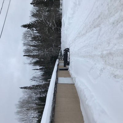

Post by Tiger Tim » Mon Jan 14, 2019 4:25 pm
Well this might be really disappointing but all I did was wait for a milder day. There was no pre-heat, oil change, towing or anything. All I did was another half turn richer on the carb which I took back off again as it warmed, as one often does. It was a nicer day so I just gave it a shot before trying anything else. The T is in my new garage safe and sound!
Lesson learned: when parked in neutral, SAE30 is basically glue at -19*C (-2*F) but limber enough to start by crank with all wheels on the ground at -2*C (28*F). This is with Ford’s original all steel clutch pack too. I say that as a data point, not to rub it in anyone’s face.

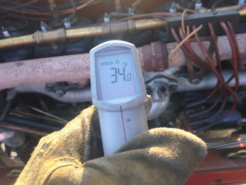

I've started our cars both in neutral and in high gear, with both wheels off the ground. Two problems I've encountered when in high gear. First, if there is a backfire or even when the car sputters, the entire drivetrain must take whatever shock occurs. You see, and feel the stress to the entire driveline as the wheels go, sputter, stop, reverse (slight kickback) and the entire drivetrain is at risk. Secondly, i'm forced to turn the entire drivetrain by crank when in gear. This may not seem like much, but with a Model K, this is nearly impossible when dealing with cold engine oil, cold transmission grease, and cold differential grease. By using neutral, the drivetrain will take the path of least resistance, and the transmission may slip some and give me a better chance of getting enough cranking speed for the engine to have a chance to turn over.
Below is a video starting our K when the engine is 34 degrees. If you watch it, notice the front springs/suspension as I try to crank it cold. Then, watch the rear wheel when the K is jacked up to start. Although the car is in neutral, the rear wheel turns immediatialy as i crank, helping offset "stiff" oil and grease:
https://youtu.be/s8bzvv6JV-s
