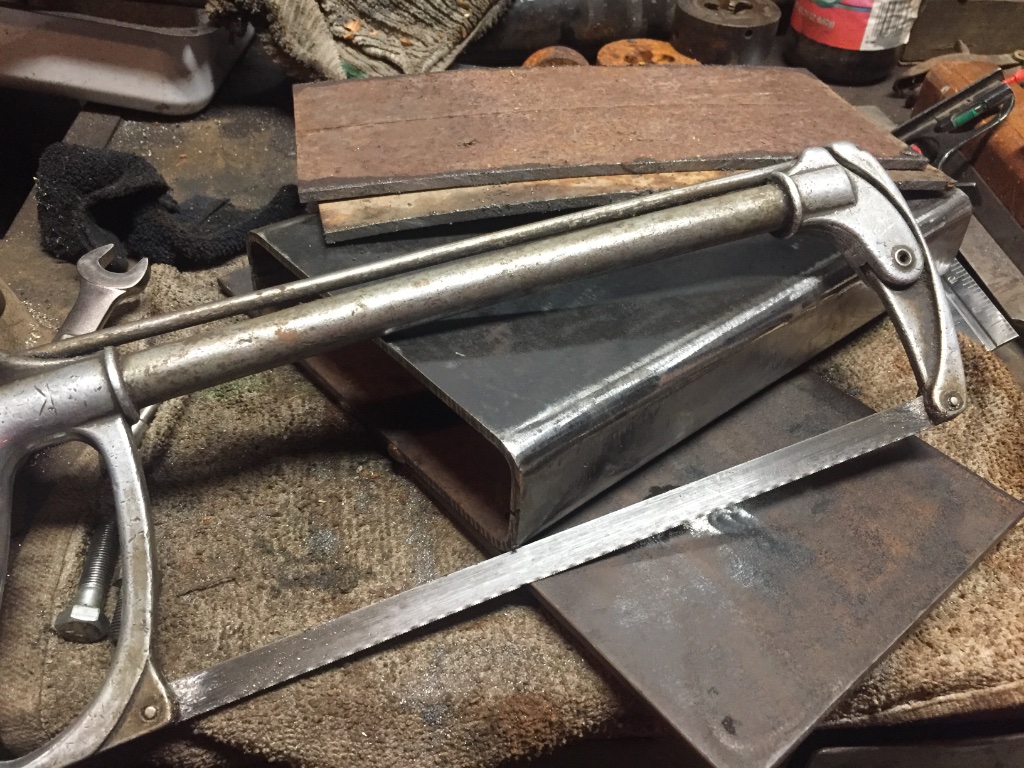

My plan is to use a tube design. I cut down a 8x8 inch to a 2x8 .25 thick tube.
I cut the tube with a hacksaw and welded it back together:

Nice old hack saw! My arms hurt for you if yours didn't. 1/4 wall, uff da.

Yeah cutting four feet of quarter inch steel was a fun task. I should do advertisements hacksaw blades ;) This hacksaw is really the best one I have ever used. I have a angle grinder, but wanted to work inside and only had half a cutting disk left. Sometimes in patients gets in the way of laziness! Those bent strips on top are what I cut out. I plan to use those for the base.

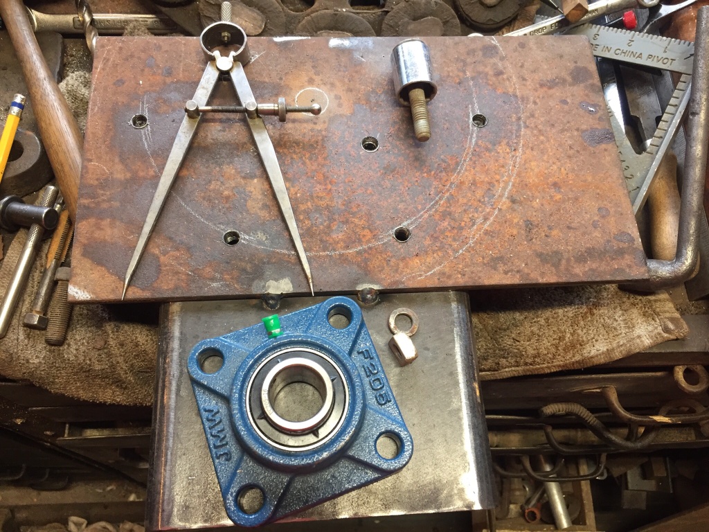

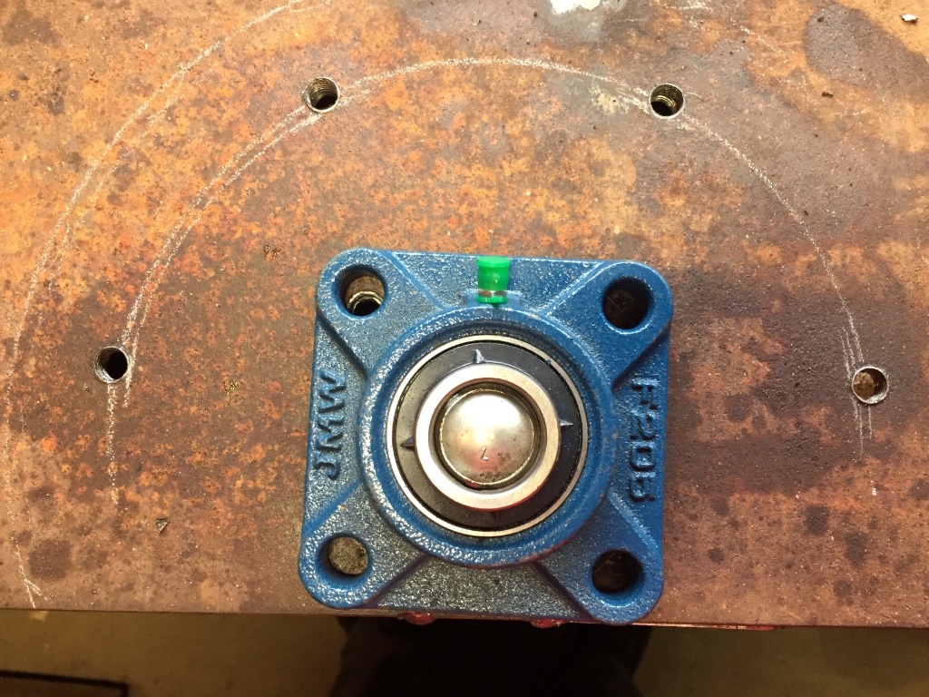

I started drilling holes for the flange bearing and ran into trouble.
Things were not lining up. I’m not sure if I didn’t follow the measurements or does bearing was just different. I decided I needed to use the main shaft for as a reference. Does seem to be close enough for the magneto holes, Even though the lines don’t look perfect:
I decided to drill the center hole where the shaft would go and use a socket to center the flange bearing for drilling.
You can see how far off the first hole is:

The next step was the fun part! Not everyone has capacity to drill a hole over 1 inch. But not too long ago I was at estate sale and purchased some large Morris taper drill-bits.
Look how small those other holes look!
I was happy to see the shavings were not getting too hot. I did drill a half inch hole as a starter.
Things are looking pretty good with the bearing and shaft in place.

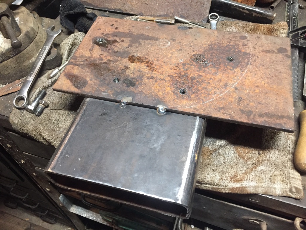

Drilled some holes and checked fit:
Welded it on:
I consider myself more of a grinder than a welder… In this case I just left my welds.
