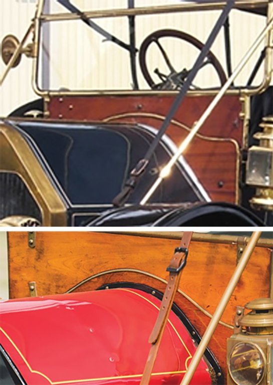

I am in the process of buying a 1914 Speedster that was built by a Ted Oney in Oklahoma. That car has the original monocle windscreen. I want to fit a full width windshield, preferably one piece. The firewall appears to have been customized: not sure. Anyway, I have attached two pics and wonder if anybody has an ideas for installing a windshield. Thanks! Bill

I would think that firewall would want something like this to give a little more support. It may need support rods.

Richard has the right idea - either utilize the original '13 - '14 w.s. clamps along with additional supports (homemade & longer) for placement at the lowered corners of that firewall OR replace with a stock dimension firewall.
Obviously, that firewall was "clipped" to emulate the shape of the brass radiator.

You could swap out the firewall with a standard 1914 full width and height firewall and then attach the windshield with a couple of vertical supports like were used on the open runabout from 1911.

A speedster is a home-made car, and in this case that means the firewall too. Maybe you want a stock firewall for this car. See Lang's catalogue for drawings of all the wood firewalls.

This might be a good design.
It was on the HME video Tim posted.

That car posted by Rich looks very nice and may be my easiest solution. Whose car is it? Bill
