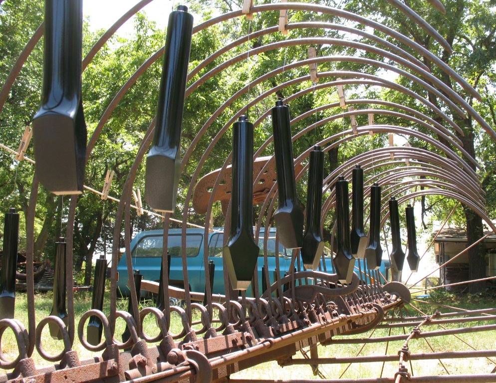

Re: Spoke fit question
I'd assemble the wheels with no paint other than primer. Paint will add to problems pressing things together, and will act as a lubricant when in place. Do the finishing paintwork after assembly.
I have assembled wheels with the spokes painted. I did avoid painting where the spokes fit together. There was some very minor overspray and it was not a problem. I do like to rub a candle on those flat places to help them slide into place.
I also painted the metal parts before assembly.
