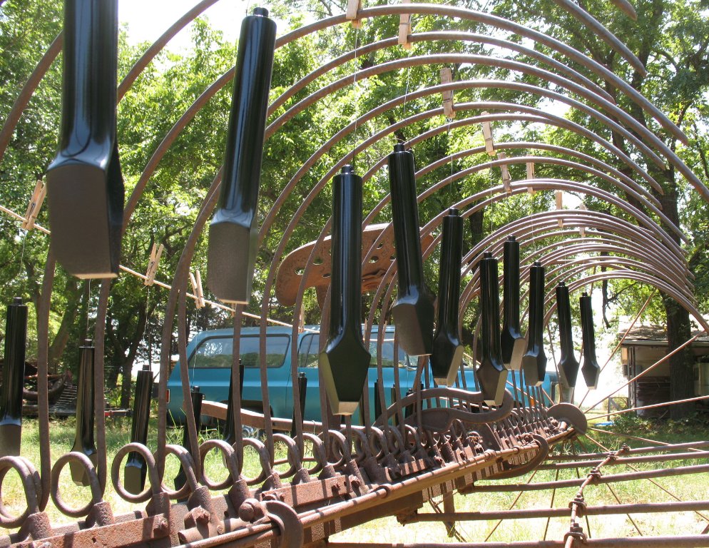

I have assembled wheels with the spokes painted. I did avoid painting where the spokes fit together. There was some very minor overspray and it was not a problem. I do like to rub a candle on those flat places to help them slide into place.
I also painted the metal parts before assembly.
