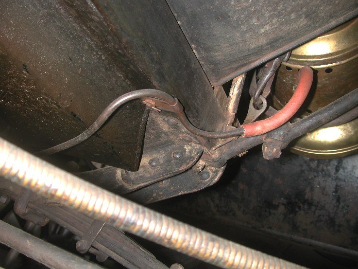

Scott what "sharp bends" for the passenger side? There were no sharp bends for 1911.
What year are you working on?
Here is an image of (I believe) Kim Dobbins' 1910 passenger side:

by Scott Rosenthal
Yep, that's that's the one Keith. Using a coil.spring to bend it vs. brake line bending tool. Pretty much same as Bruce's photo shows. Made the brakets some time.ago, so just about to solder it all up. Did you solder ferrules on your tube ends, and did you use hose clamps or not?

Neither. I have a friend who has an attachment for his flaring tool that makes a bulge at the end. We used that and it worked great. Otherwise I would solder ferrules on to the ends even though they not made that way back then. No clamps. When the hose is in place you can't tell the bulges are there. Just spit on the pipe and slide the rubber tubing on.
