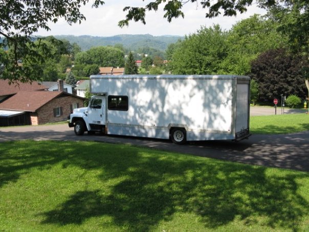

Tom, in both of our race trailers and the hauler truck we are using the Harbor Freight winches with remote controls. I do not buy the synthetic rope from H/F, -but instead buy the colored 10,000 lb rated, ΒΌ" synthetic rope that are listed all over eBay for about $20.00. Most of those have the metal spool in the end by the hook. The only thing that is tricky is you will need to work at getting the end of the rope attached into the hole in the winch drum, but as soon as you have a few wraps on the drum, they work well.
One thing for us/me is I do not like to wait on a winch to pull the vehicle in. In our haul truck, we have a 12k rated winch and in all the others we are using an 8k winch. A smaller 2,500 lb. or 3,500 lb. winch will do fine for your application however the gear reduction to be able to use a small motor to pull that load with those winches makes the drum speed too slow for my liking. The heavier weight rated winches never slow down with a load as light as a T or A, therefore the car is usually inside within 60 seconds from start to finish.
