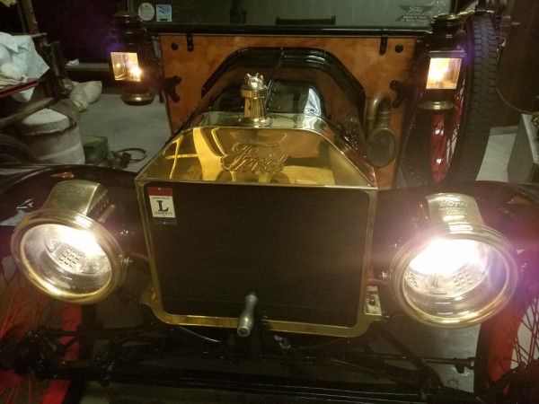

LED Light lamp to replace carbide headlight? I would like to install LED lamp in a carbide headlight. Where can I find bright ones?
Here is a picture from Lang to show what I want. These sold by Lang are too dim according to their description. Looking for something brighter.
[EDITED]
I did not mean that I was impugning Lang's product here is their copy with these lights
"The LED bulbs are not as bright as the original carbide bulbs or some of the halogen bulbs that has been offered over the years. They will be able to be used to get some light out of the car but if you are planning to drive at night a brighter bulb is suggested."

I think "too dim" is an arguable statement. I have some of Tim's LED lights just like in the picture in my 1914's lights, -and they are great for in-town traffic coming home from a show or dinner where street lights also help illuminate the way. In a rural area without any street lights, most would agree they are probably not enough light HOWEVER I'm sure we all agree they are a vast improvement over the lumens created by just a carbide flame. :lol:
Have you considered temporarily adding an auxiliary LED driving light under each fender, or possibly temporarily mounting a small LED light bar onto the front axle? The size wiring required for this is very small and could be discreetly placed when not connected to the light(s). Harbor Freight and other places make some very strong magnets that would be perfect for temporarily mounting auxiliary driving lights to these locations on your T to supplement the Brass lamp LED lights.

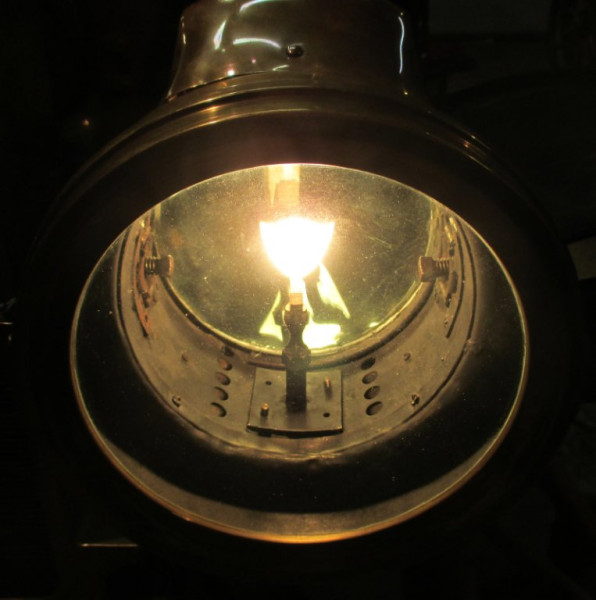

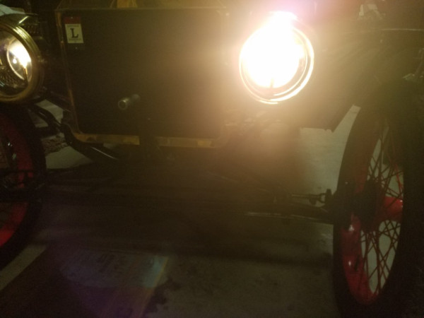

I tried using those LED lights in my 1914 Touring car and they were not very good. It did not help that my headlight mirrors were also scratched up. If I was on a country road with no traffic going slow they were OK, but as soon as there was a lot of traffic the only thing I could see was the light from other cars.
I replaced those LED lights with the Headlight Quartz Conversion Kit and they are very bright.

As for replacing the bulb, as I said, I originally purchased the halogen bulb assemblies through Snyder's https://www.snydersantiqueauto.com/prod ... &cat=41889
the assemblies are very well made and really nice. They have a custom made holder that threads directly onto the gas burner pedestal. The bulbs are epoxied into the holder to make sure they are held exactly at the center of the mirror. The bulbs seem to be of a high quality that will last a long time. Unfortunately, I had to have one replaced because I took my headlight apart to repaint it and I dropped the assembly and broke the bulb.
When you purchase these bulbs there are instructions stating that if you have any problems, please contact "Ron Gocek" who is the guy at "Vintage Brass Works" that hand made them. I sent my holder with the broken bulb in and he epoxied a new bulb into the holder and quickly sent it back....and it did not cost that much. Ron was very helpful. I am sure that if you have any questions he would be happy to answer them for you. Ron is at 610-614-1943 and his business is in Nazareth, Pennsylvania. He may be starting to make LED versions now, but you would have to ask him.

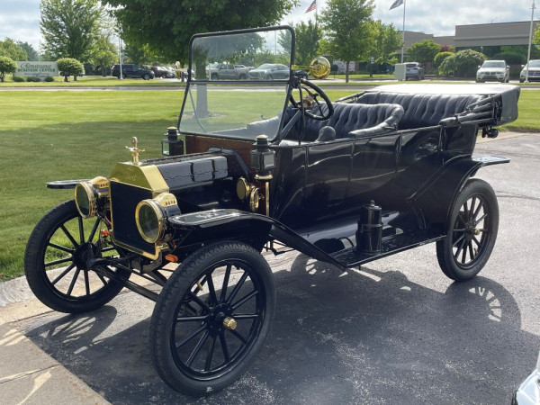

As for the turn signals....the only ones I could find at the time were kind that were on my Model A. They may not look like they should be on a Model T, but they are bright, reliable and the controller is easy to hide.
Here is where I got the kit...Item Number: 236-607
https://www.logolites.com/products/turn-signals/
If you select the picture you can zoom in and see them under the headlights and over the back fender.

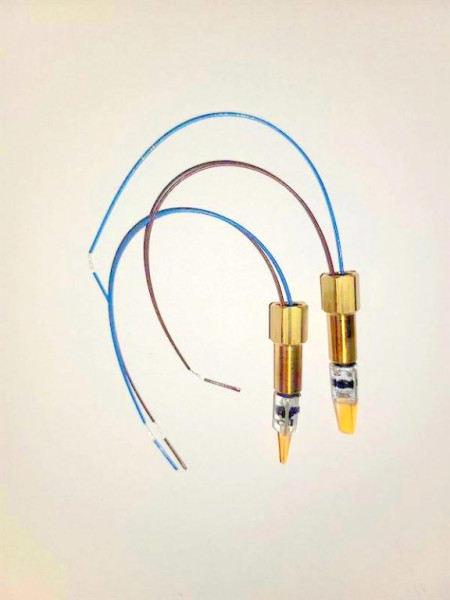

I am the one making the LED kits . new brighter bulbs have been found Langs should have them in stock now. If you would like the new bulbs please get a hold of me . Old bulbs were 2w equal to 20watt halogen bulb. The new bulbs are 5w equal to 50w halogen . Plus the LED bulbs draw a lot less amps, also the LED bulbs are replaceable if they burn out. Some people like the warm glow of the 2w as it looks original and some people want the super bright for driving. The reflectors play a big part in any type of bulb used .
