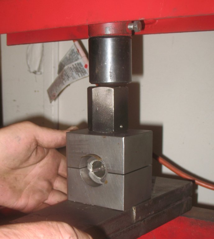

I don't know if this is still a problem, because the picture is ten years old.
At that time new cam bearings weren't quite round, and Mike Bender used this fixture to press them into a proper state of roundness.

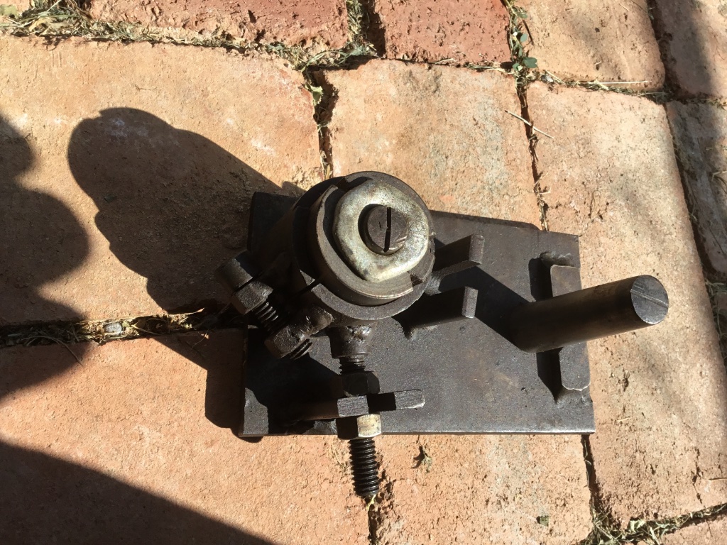

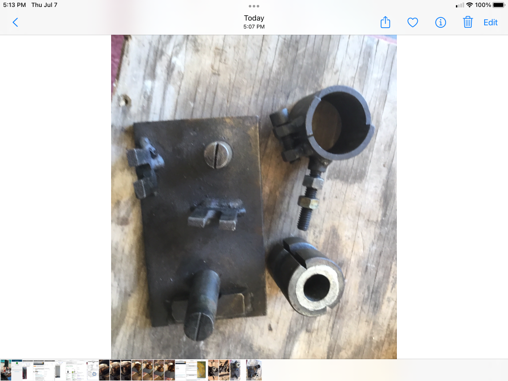

Re: Fitting Camshaft Bearings - Opinion Wanted
Built this jig years back. The cores must have rough mating surfaces imo if they don’t look as if it’s a fresh break on each half the shells are no good. Here’s the jig I use, then chuck the bearing and cut it to fit the camshaft in a lathe. I’m at 903-824-1949 if you have questions.
