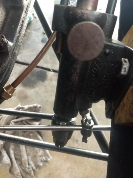

Ok,I went and took pics.
When I posted the question I was in the shop on that computer that I can't get to find photos on the cellphone.
I had the column looking nice but now will have to touch up the paint.:(
so here is what I have,From what i read in your post ,the carburetor may have the wrong throttle shaft?
The rod measures 15 inches on the table,

Re: Carburetor control rod
Posted: Mon Feb 13, 2023 11:00 pm
by JTT3
Mack if it touches the case of the starter you’ll have problems quick plus the way you have it mounted now it’s actually pulling on the post.

FWIW. The brass starter cable nut goes on top the insulator.
The steel nut goes on top of the cable.

I woke up at 4:30 this morning and it came to about the cable. If there is vibration or something bumps it ,the terminal would come down and arc. I don't why it took me a while to understand but hey,I am a bit slow.
