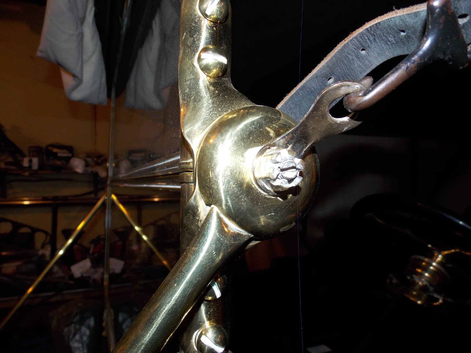

John Haynes contacted me and emailed some photos of his 1912 touring to me. Thank you John for your help!
The figure eight shaped top buckle loops on his car are original but were re-plated. The top straps are not original, but show the mounting location for the straps that are attached with footman loops.

Thanks for the reply Kim! I am very much looking forward to meeting you in a week.
Your 12 has the other type of short strap to top attachment used in 1912, where the strap is just looped around the bow and held with a buckle.
It should be mentioned here, for anyone doing research on this subject, that the early 12's used the long straps that attached to the eyelets that were part of the front fender irons.
It appears that the 1912 figure 8 strap loop on the windshield is very similar to the 15-22 style, except for it being brass plated. Can anyone compare the two and report what they find?
