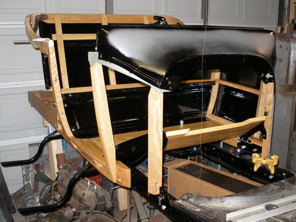

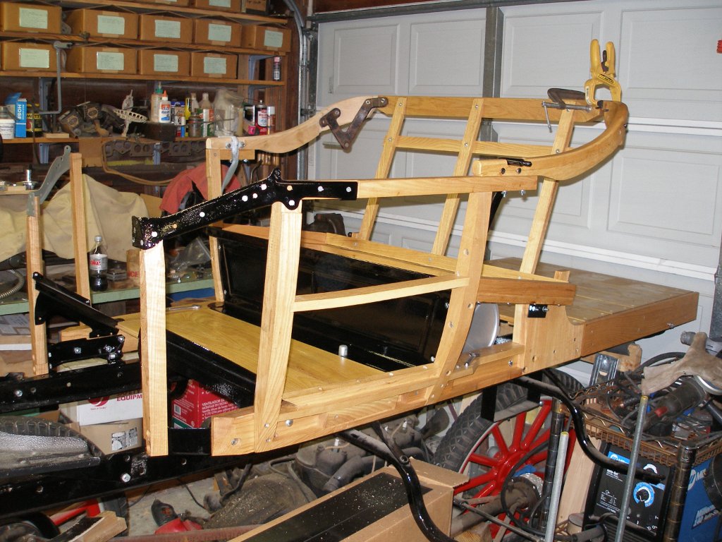

my '23 low cowl runabout had the steel former that joined the cowl to the side panels. On each side, it had two rivets at the lower front of the cowl, diagonally across from each other where the carriage bolt came out to hold the firewall, and one rivet on the side that held a tab sticking down from the cowl. I do not remember their sizes.
- Posts: 4696
Re: Body Panel Rivets
Nice photos of your 23 Runabout. Interesting point about the two rivets you mentioned. I wonder if the low cowl 23 Tourings had the same two rivets you mentioned. Seems like it would since the front portion of a Touring would be the same in structure and etc? Or really close to it?

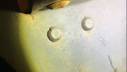

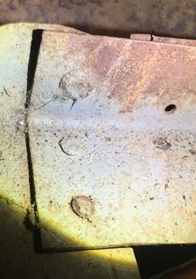

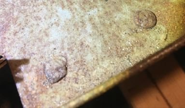

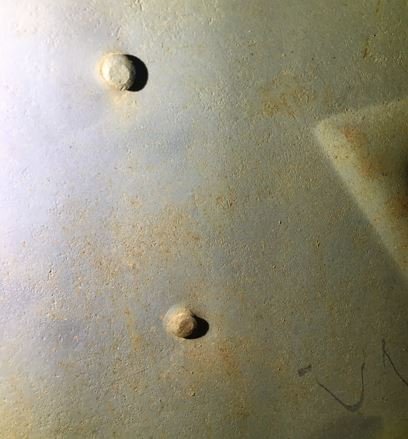

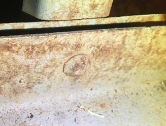

Sorry I should have included photos, correct these are on the seat frames.

Hard to tell but it appears like a couple different size rivets?
to your question: rivet sizes are by the diameter through the hole (grind the head or riveted side off and you'll have the "size" staring you in the face.
once you have the size, you usually are left with but one choice for the head
the real question is: how long should the rivet be? And the answer to that is the rivet length should be long enough to go through all parts to be joined and then stick out 1 1/2 times the rivet's diameter (in order to form a correct head)

Steve I have a 21 Touring I restored. The seat framework in riveted together as shown in your last photos just as mine is in my car. The body panels themselves aren’t attached to any seat frame rivets that I know of in my car. Maybe different body makers or later low cowl cars had them attached to the sheet metal panels but mine didn’t.
As far as disassembly you don’t need to dissemble the seat frame work if the rivets and metal framework are still stable and in good shape.
I hand sanded and primed and painted the seat frames and that was it.

Thanks everyone for the information and help. The only rivets that I need to replace are on rusted out sheet metal on the seat frames. I did have to remove the rivets that hold the back sheet metal onto the seat frame supports. I had to do that to get access to the back of the rear seat frame where rivets are that I will need to remove. The rot on the rear seat frame is the seat pan that is on the bottom of the rear seat frame. Mostly rusted out and needs to be replaced. On the front seat frame the toe kick needs to be replaced. Again more rivets. As far as I can tell that's the only rivets in the body sheet metal on my 1920 touring car.
