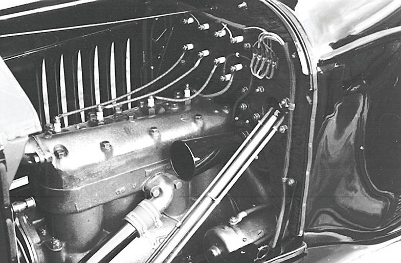

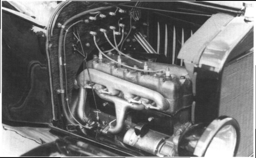

A couple of period photos. Perhaps you can eye the location based upon the other parts near the terminal block. Also shows the route of the loom clamps. Jim Patrick

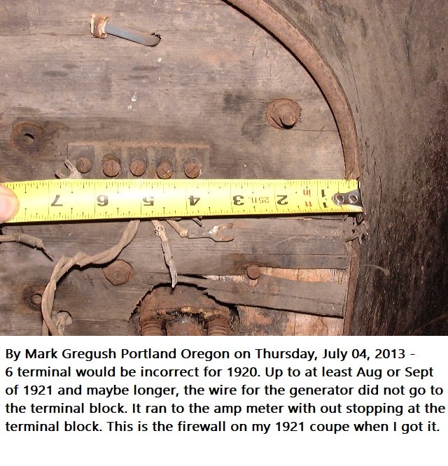

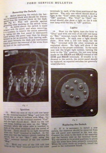

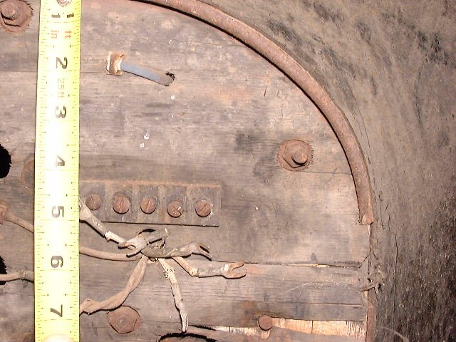

Here are some measurements pictures from this link https://www.mtfca.com/discus/messages/3 ... 72291.html
from another link
