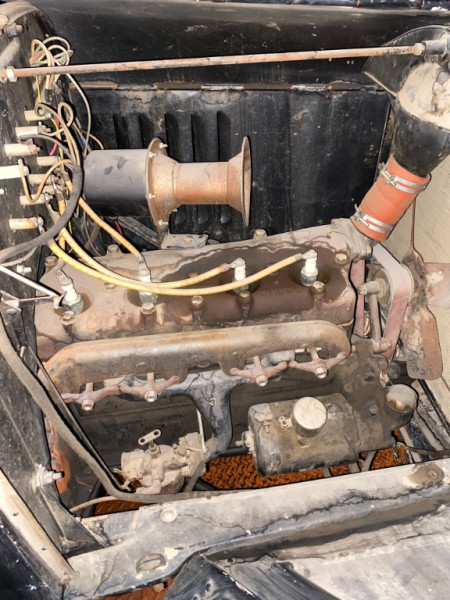

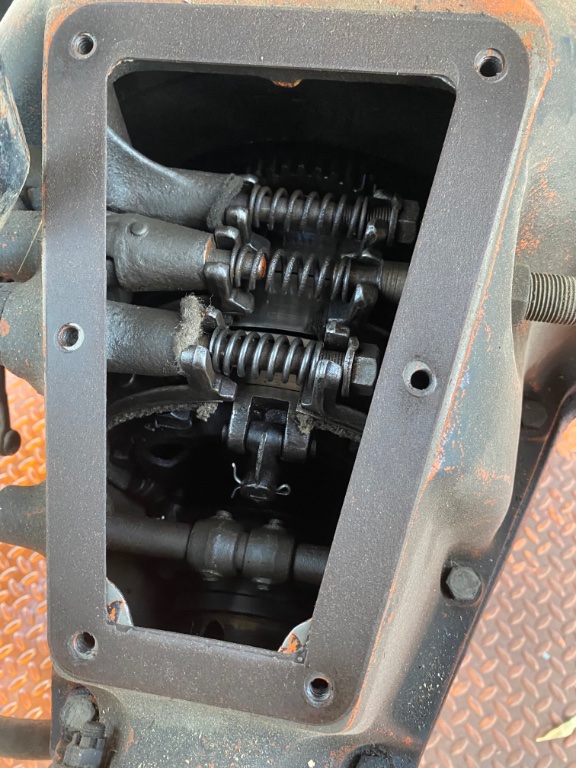

Here’s 2 pictures, one of the engine and one of the transmission from the inspection port.
- Posts: 4684
Re: Model T engine or transmission locked up.
Your brake band looks a bit odd. There is loose band material in the fork where the shaft goes through next to the spring. Can't tell from the picture, but looks like something might also be stuck under that edge of the band. It is possible some of that could be locking the brake band and causing the brake to bind. Also depending on what kind of oil you are using, the cold weather could be causing thick oil to bind the clutch disks, however if the Warford is in neutral, the clutch disks should not cause it to stop turning. In order to determine whether you have anything stuck on the magnets or starter ring gear, you would need to remove the hogs head to inspect.

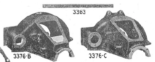

Norm isn't that a large drum hogs head on a small drum trans?

- Posts: 4239
Yup, that's what he's got there.Craig Leach wrote: ↑Sun Feb 26, 2023 5:02 pmNorm isn't that a large drum hogs head on a small drum trans?

Thank you for the suggestion Norm. That picture was from a while ago so I pulled the material of the brake band and it looked like it was a felt washer. I am not sure of the history of this truck because it belonged to my Great grandfather who has passed on. I do know that it was overhauled in the late 80’s or early 90’s but that is about it. The only modifications that I know of are the Warford transmission and the water pump. What does it mean if I had a large hogs head on a small drum transmission? I also have a 26 TT C cab that also belonged to him that is in storage. Could it have been swapped for that one? Anyways, I will try reversing the crank the next time I work on it which will most likely be next weekend. I’ll keep you guys posted.

- Posts: 4321
Great catch Craig L!
- Posts: 4239
It means that the brake band will not be centered on the brake drum. See how the band hangs over the back of the brake drum? It's not supposed to do that. The brake band should be located nearer to its neighbor, with maybe just an 1/8" gap between the two.Jacob Mangold wrote: ↑Sun Feb 26, 2023 5:41 pmWhat does it mean if I had a large hogs head on a small drum transmission?

- Posts: 4961
Agreed. Not sure this would cause the lock up.
I am thinking a previous owner may have dropped a nut or washer down in.
Removing the HH will give you a good look @ the magnet keepers & possibly the dropped hardware.
Since you dont know the history, you should pull the inspection cover. Have a good look around. Could even be a busted rod or crank.

Will it still work with this hogs head Jerry? Will it cause me more problems down the road? Also, I don’t think a rod or the crankshaft would be busted because I was just cranking it by hand but I will look anyways.

- Posts: 6601
Jacob
you really must put the correct hog's head on the transmission. As it is, with the later one installed, your brake band is riding off of the brake drum due to it being positioned offset to the drum and expecting a much wider drum to be under it than there is...so now that you know that it MUST come off for replacement, you can take the opportunity to study what's going on inside.
Scott, how do I tell the difference between a large drum and small drum hogs head?

- Posts: 1983
- First Name: craig
- Last Name: leach
- Location: Laveen Az
Jacob,
The large drum HH has a larger bulge on the right side, should have two ears on the top to bolt it to the engine, the spacing between the

- Posts: 6601
the large drum hog's head (meaning "wide" brake drum) has the pedal shafts spaced differently than the narrow drum hog's head.
your hog's head is meant for a wider brake drum...because your brake drum is "narrow" or smaller, your hog's head has the brake shaft much further "back" and the brake band is running off of the narrow drum...if your drum was the later, wide style, the brake band would fully cover the drum and would not be running off of the drum.
"Wide" brake drum transmissions were from late 1925 through to the end of production in 1927. Being that your truck is a '24, it correctly has the "narrow" brake drum in the transmission, but someone has fit the latter hog's head over it.

One blatantly obvious clue makes it easy to ID a 26-27 hogshead. It has those two "ears" on top with holes in them for bolting it to the back of the engine. All previous hogsheads lack the ears.

With the hand brake pulled back check the clutch figure see if they are loose and set right

BTW brake & Rev. Band appear to have soft material between the band ears and the hogs head?

It might not be this but it has happened, cranking it slow then it locked up, one thin to look at is the u joint pin might have fallen just enough to lock up everything, Bob

That is another possibility. Its easy enough to check. Remove the upper & lower pin access cover bolts & have a look.
The pin would normally fall straight down.

If is a 26_27 Horseheads it will have 2 ears with 5/8 holes that bolt to the back of a 26 or 27 block. They used the wide brake band.
