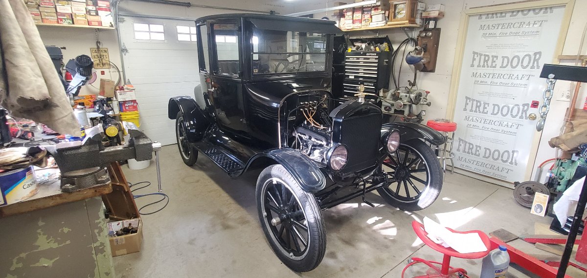

Posted: Mon Apr 24, 2023 10:46 am
by Steve King
After a couple months work I started the rebuilt 25 Coupe engine last night. What started with complete magneto repairs ended up with a rebuilt engine, new Kevlar band linings, and replacement of transmission parts with good used that I had. I drove it lightly around the subdivision this morning. It shifts good. I had set up the mag field coil to magnets with a vertical engine and clearance of .032". It starts on mag. Wondering what people are using for break in procedures. I will be doing the usual head re-torque on this Z head a few times when it's cool.
