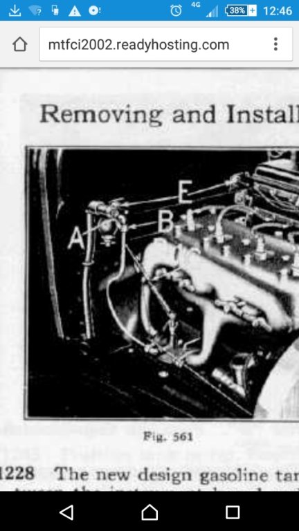

Re: Installation of the Fuel Line
Posted: Wed Mar 22, 2023 11:01 am
by TXGOAT2
I would make up a fuel line that closely matched the one in the Ford manual picture. Yours as shown may not resist vibration and normal flexing as well as it should. You do not want to make a line any longer than necessary, and you do not want any loops in it. The Ford design is the correct one. Use the correct materials and fitting types. My car has an incorrect glass bowl filter on it, and the outlet on it is in a different location than on the original style bowl. The fuel line on my car is steel, and it is similar to the one in the Ford manual picture, except it is upside down.
Posted: Wed Mar 22, 2023 11:52 am
by Jerry VanOoteghem
I would go with the "inverted question mark" style in the factory photo.

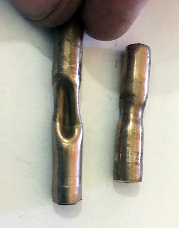

Posted: Wed Mar 22, 2023 11:54 am
by Oldav8tor
